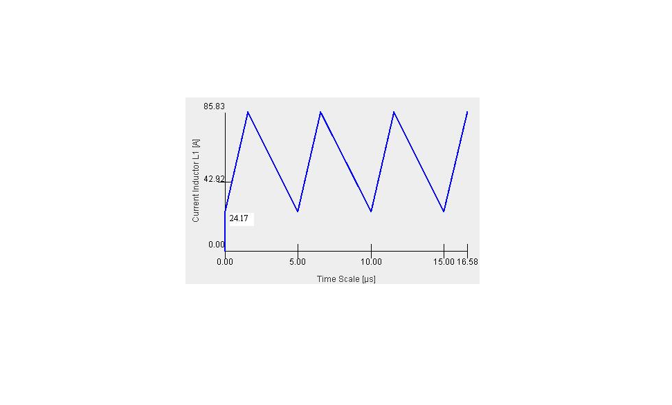

  • Hi John,
    Let's take this attached current waveform of a output choke of a full bridge converter as example.
    The switching frequency, Fo = 200KHz. To = 5us. Assume Duty cycle is 50%, then Ton = 2.5us. During Ton = 2.5us, dI = Ipp. By taking the slope-rising triangle into calculation, then Q = 0.5 x dI x 0.5/Fo = 0.5 x Ipp x 0.5/Fo.
    But your formula is Q = 0.5 x (Ipp/2) x 0.5/Fo. Why there is (Ipp/2) in your formula while mine is only Ipp?
    Another question is why the dVout = 25mV while maximum spec for peak to peak ripple voltage is 100mVpp? Do you mean that 25mV ripple voltage is due to the charge and discharge of output capacitor while the 75mV is due to the ESR of the output capacitor? What is the selection criteria for this 25mV and 75mV?
    Thank you.
    KK
  • KK,
    If you assume the worst case condition occurs at 50% duty cycle for the output current ripple and calculate the charge into and out of the output capacitor on each cycle you can identify the ripple voltage in that capacitor as a function of peak ripple current capaitance and frequency.
    In this case that came to 25 mV.
    The remaining 75 mV is not defined in the paper but it would be a result of the ESR of the output capacitor. See the attached for a more detailed explanation.
  • Hi John,
    The Vcap = 25mV is due to the dI = Ipp/2, then Vcap peak to peak is 50mVpp. But we assume Vesr = 75mVpp. The total peak to peak ripple voltage = 50mVpp + 75mVpp = 125mVpp which is > 100mVpp, the maximum specification.
    If the Vcap is 25mV, then Vesr assumed should be 50mVpp. The % selection for Vcap peak to peak and for Vesr from the maximum specification of peak to peak ripple voltage is 50%.
    Thank you.
    KK
  • KK,
    The 25 mV is the change in voltage on the output capacitor because of the change in charge. The remaining voltage is a result of the current in and out of the capacitor and the ESR of the capacitor. It is simple I x R = V and the current goes in both directions so it is a plus and minus voltage.
    You can select whatever you want for your design conditions  but the end result the ESR of the capacitor will set the voltage change on the output cap as a result of internal resistance.
    You can trade off a larger cap to allow more ESR and get the same total ripple voltage because the change in the voltage as a result of the accummulated charge will be less.
