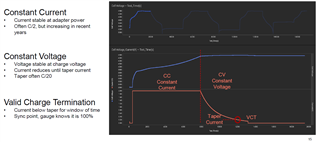

    Setting the charge with a rate of C/2 in the learning cycle does not make sense to me. we use BQ25606 and its cutoff current is 5% of its charge rate. The tamper current is set in the gauge based on this value right?
    Lets say we have two identical products that use bq27441 as a gauge and bq25606 as a charger and they use the same battery type. the only difference is that product A has a charge rate of C/5 (therefore cutoff current of C/5 *5%) and product B has a charge rate of C  (therefore cutoff current of C *5%).
    if we perform the learning cycle with a rate of C/2, we will have to define the taper current before the leaning cycle to be (C/2 *5%)*120%. This cannot be applicable in both product A and B right?
    in this example the only solution is to do two different learning cycle for both A and B and use their charging rates in the learning cycle right?
    What I understand so far is that two different products with different charging rates can share the same learning cycle, but if they have different cutoff currents, they cannot share and two learning cycles are needed. could you elaborate on this point please and confirm if it is right?
    Malik
  • Hi Malik,
    The C/2 is a recommended value. You can charge at rates lower than C/2. C/5 should not be a problem, it just takes 5 hours to reach charging voltage.
    Same for taper current, often recommended C/20, but it could be any value from C/10 and C/100. See below for better description.
    One hint is to set the taper current in the gauge 10% higher than the charger taper. This is to ensure the gauge detects full charge before the charger does.
