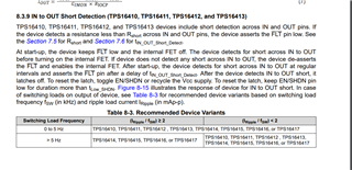

I think the TPS16411 circuit has enough room, but FTL occurs within seconds to minutes when the RADAR UNIT operates.
We also changed the RC parameters of PLIM and IOCP sufficiently. However, I cannot confirm valid results.
Please check the attached PDF file.
TPS16411DRCR FLT analysis.pdf
And I am currently doubting whether the problem is 'In to OUT Short detection' and would like a detailed explanation on this part. I would like to know what 'Switching freaquency' mentioned in the data-sheet means.
