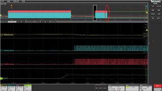

  • Hello,Nicholas
    For your question:
    1. I try to reproduce it and record the scope twice as below. By powering on and powering off board again and again. The time of power off is about 1-2s.
    TP66 is pin20 of PMIC_A.
    TDA_VDD_MCU_0V85 is Buck1 of PMIC_A.
    2. It occurs sometimes, maybe 1/10~1/100. And it just occurs on a few boards.

  • I reproduced this abnormal issue by power on it and power off it again and again. The time of power off is about 1-2s and you can find it in the scope.  Based on your suspicious direction, I will test the time to let voltage drop tomorrow and develop the new test case again.
    Anyway, I think a power down time of 1.5 seconds should be completely sufficient for PMIC ICs. What do you think of it?

    Thank you for following up. On that scope shot could would it be possible to give a measurement on that LDO4 of PMIC-B as soon as the enable occurs.
    Also the interrupt registers are showing a SPMI error occurring as well, if possible could you probe those SPMI lines to see the communication on them?

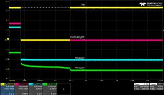

    3.As you mentioned before, it may be caused due to no completely discharging. So we reduce the capacitor value and make it can discharge quickly(we have checked and all LDO pins can discharge quickly not only for PMIC LDO4), but this issue is still easy to reproduce.
    PMIC_B LDO4_discharge slowly
    PMIC_B LDO4_discharge quickly

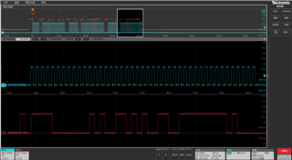

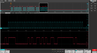

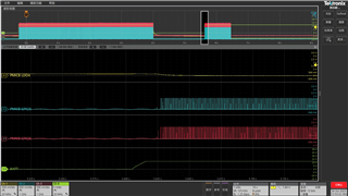

    4.We test SPMI when this issue reproduced and the scope is as below. The previous cycle is good, then power off, then power on, and the following cycle is an abnormal situation.
    Could you give further comments based on the test results?
    1. The discharge slowly scope shot is from the original capacitor setup?
    2. The quick discharge scope shot is after the capacitor change?
    This is after change in the capacitor values I assume?
    If there is a scope shot where I can see the data and clock lines closer to check if there was an ACK or a NACK from PMIC-B, I can't say definitively before seeing them closer.

    2.The discharge slowly scope shot is from the original capacitor setup?
    An: I think so. We use larger cap than EVM. When I reduce the cap value, it can discharge more quickly. Anyway, this issue still reproduced.
    3.The quick discharge scope shot is after the capacitor change?
    An: Yes.

    1. The real issue now is the SPMI error, and there could a few issues with that, but could you possible provide scope shots showing the clock and dataline for the SPMI?

  • 1. The real issue now is the SPMI error, and there could a few issues with that, but could you possible provide scope shots showing the clock and dataline for the SPMI?
    An: as below.
    Normal state:
    Abnormal state:(the last cycle of abnormal SPMI)
