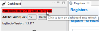

Hi all,
We are building a battery pack with BQ34Z100 fuel gauge and BQ76952 battery monitor. Currently, we are facing a communication problem while trying to connect with EV2400 trough I2C. Computer detects the fuel gauge just fine, however, we cannot connect to the battery monitor as it always detects the fuel gauge but not the monitor.
Both devices are sharing the same SDA and SCL lines. As I was absolutely out of ideas why it won't connect, I tried to cut SDA line going to the fuel gauge... and it worked... I have successfully connected to the battery monitor. So, are there any reasons why these ICs would interfere with eachother? Furthermore, what could possibly be the root of this problem - firmware? hardware? something else?
