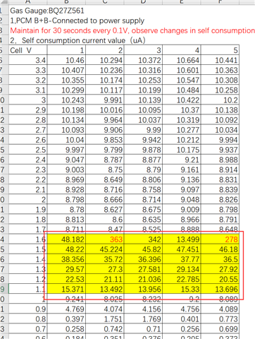

BQ27Z561 has encountered a problem in its application. Please help analyze the cause:
When the cell voltage is higher than 2.5V, all applications are normal;
2. However, when the cell voltage drops to 1.6V, the power consumption of the IC shows abnormal values, such as several hundred microamperes, and slightly smaller ones all have 40-50 microamperes. As shown in the attachment, 5 pieces of data were tested;
3. Until the battery cell voltage drops below 1V, the power consumption becomes normal again.
Can you help me comment on why?
 Thank you!

    Supply current during normal operation has a typical value of 60uA. It looks like the "several hundred microamperes" are only seeing when the device BAT voltage is at 1.6V.

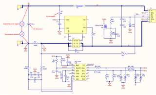

    Do you have any circuit that activates when the BAT voltage drops to 1.6V? Any sort of secondary supply in your design? This is a strange behavior and only happens at a certain voltage.
    Jose Couso
  • Hi Jose Couso,
    Please check the schematic diagram. There is no other active circuit.
    Luo Lixin

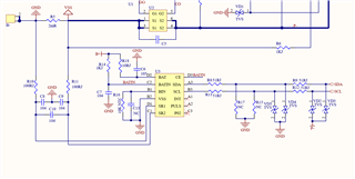

  • Hi Luo Lixin,
    I do not see anything alarming with the BQ27z561 schematic.
    What is U2?
    How easy can you replicate this? How do you measure the current consumption?
    Jose Couso
  • Hi Jose Couso,
    1. U2 is a MOSFET, The following is the complete circuit diagram,J1 is the output port of the battery pack and nothing is connected.
    2. During the test, R1 is removed, and the cell is disconnected. Adjustable DC power supply is used, and an ammeter is connected to the power supply in series.
    3. Change the voltage of the DC power supply, read the value of the ammeter, and get the test record sheet when the first problem occurs.
    With this information, can we find out why GAS GAUGE consumes so much power?
    Luo Lixin
