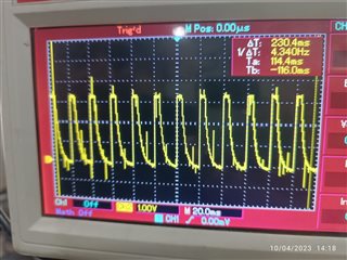

Hi
We have developed our BMS board based on BQ76952. We have followed BQ76952EVM schematic.
BAT+ is 52 Volts.
On Q2 base it should be stable 6.0  volts but we are getting transients as in following figure
and at the emitter 5.5 vols (stable) but instead we are getting the following.
Therefore, there are transients at the LDO outputs REG1 and REG2. These are configured to produce 3.3 volts.
REG18 is giving stable 1.8 volts.
Please help to identify what is wrong with the circuit or with BQ76952.
