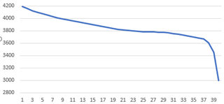

    1- For two battery chemistries to be compatible, there's more specs to look at than just the max charge voltage. Each chemistry ID in our data base has a unique OCV table. I suggest to either get the exact cell for chemID 1202, or use the GPCCHEM tool to match the cell you are using with one of our database.

    1- Obtain the same cell chemistry defined as chemID = 1202in my previous reply.
    2- Purchase a flash gauge. Flash gauges allows you to program any chemistry. I suggest BQ27z561-R2 without protections and BQ27z746 with integrated protections.

    1. I need a clarification, basically chemistry id will define what?
    2. Also, I chose this gauge because it was mentioned that this IC will support 4.2V battery as 4.2V pre-programmed profiles were available. they didn't mention about chemistry ID and all.
    3. I went through  BQ27z561-R2 and  BQ27z746  datasheet and their pin functions are little bit different than BQ27426. Is there any flash gauge which is similar to BQ27426.
  • Hi Akilarasan,
    1- ChemID defines the OCV and internal resistance of the battery across low, room, and high temperature. The gauge uses this information to run capacity predictions.
    2- "4.2V pre-programmed profiles were available" is essentially pre-programmed chemistry profiles. The 1202 ID for example has a highest OCV voltage of 4.2V. This does not mean you can use any 4.2 Volt battery. You will need to either get the same listed cell in the picture I provided or use the GPCCHEM tool to find the most matching cell in the database and we can see if it compatible with ChemID 1202. Essentially we are looking at OCV curve compatibility.
