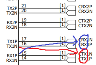

My customer is designing a circuit using the HD3SS3220IRNHR.
Could you please review the schematic below?

Hi JH,
Looking at your schematic, I see you flipped the TX and RX lines on the connector side of the 3220. You need to have the TX pins of the MUX connect to the TX pins on your connector.
Your VDD5 and OUT3 pins need to be connected to a 5V power rail. These cannot be connected to the USB VBUS because the VBUS may not always be present.
This is also the case for your CURRENT_MODE pin.
You can use the schematic in the datasheet as a reference for how this would look
Shane
Dear Shane,
I modified it according to the guide you provided.
Would you check 1 more time USB SS line as attached file.
5V line also modified.
Hi Mr. Kim,
Your SS lines look correct. I cannot see the 5V line but if you changed that then the schematic should be good.
Shane
