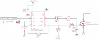

Could you confirm that WDO/ is a high impedance output?
My customer would need to latch the WDO/ to not get the cycling phenomena (explained here )

    With the following diagram, the WDO/ output is at 3.3V when the WDI signal oscillates and the WDO/ output falls to 0V when the WDI signal no longer oscillates.
    The WDO/ signal remains at 0V, it doesn't rise again. Is it a normal behavior ?
    Thank you
  • Hello Nicolas,
    WDO/ should output periodic pulses when WDI is not oscillating. If WDI is disconnected the watchode will be disabled.
    WDO/ and RESET/ are CMOS outputs and should not be connected together. This may be causing your issue.
