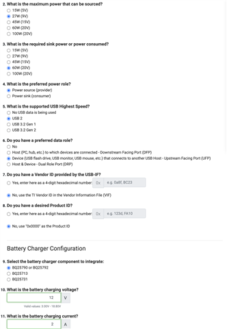

I just received the EVM and followed the instructions verbatim and cannot get the GUI output to generate >5V output.  My issue is similar to that found in another thread and it certainly would be nice if the GUI was updated to actually generate a file that works.
https://e2e.ti.com/support/power-management-group/power-management/f/power-management-forum/1278134/usb-pd-chg-evm-01-tps25750-not-sourcing-as-expected
I see the very same behaviour as Nate did in that thread.
What I have gotten to work is a single PDO @5V, but any higher voltage output that makes use of the BQ25798 fails.  Why does the GUI not have the BQ25798 listed as an option as shown in the video provided by TI?
I can provide configuration file so that someone could generate a working binary file.

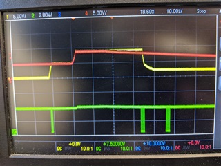

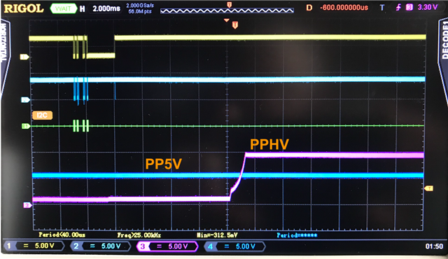

    I'm curious, does your PP5V line increase to PPHV for any contract negotiation attempt above 5V? Do you have an oscilloscope to measure this?
    This is where I measured PP5V:

  • Hi Nate,
    I did not measure the PP5V line as that supply should remain at 5V as it is connected to a one way switch within the 25750.

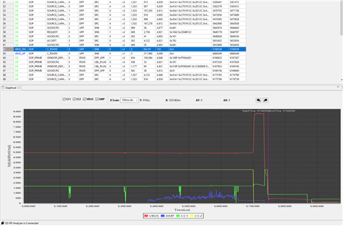

    During my debugging yesterday, I used my scope and confirmed that the output of the BQ25798 does indeed increase to 9V when PDO2 is set for 9V.  I measured on the PPHV (red) scope test point.  The 25750 does request this voltage from the BQ, but then a few 100's mS later it has some more i2C communications and the PPHV line drops.
    On the USB side during this time, there is never a confirmation of PS_RDY when 9V is present.
    The whole cycle repeats forever.
  • I would like to do more than function as a battery charger.  I would like to:
    Any chance the EVM can do that?
    What I have been able to get the EVM to do successfully is output 5V when #2 is set to 15W (5V).

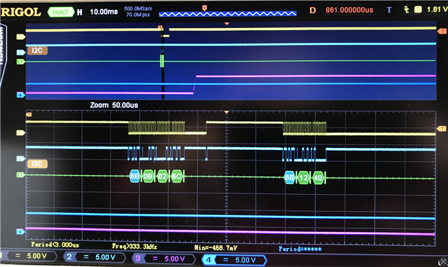

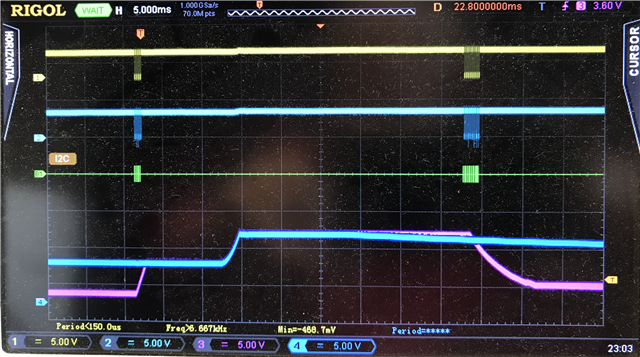

  • Hi Nate,

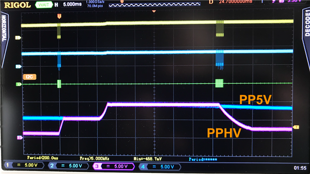

    I created a new GUI config with two PDOs, the first for 5V and the second for 9V.  Scope Channel 3 is the PPHV, and Channel 4 is the PP5V.  It can be seen that PP5V goes to the 9V just like PPHV.  Channel 1 and 2 show the I2C communication to the BQ25798 during this event.
    My PP5V measurement was taken off the output L2.  I am surprised as you were to see this happen!  Good thing 20V was not requested.  It looks to me like the PP5V FET is not shut off.
    Nate, are you able to get 9V output from the bin that Alex provided to you?  As it only ever provided 5V output for me.
    Richard
  • Captured the same as above but added the VBUS measurement on channel 2.  It is reaching 9V which to me confirms that the PP5V switch is not turning off when higher than 5V output is requested.
    PP5V reaching higher than 5V would certainly strain capacitor C26.

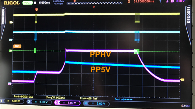

  • Of interest is how PPHV behaves with two (5V and 9V) power roles being defined in the GUI.
    When the sink requests the 5V PDO, I see the PPHV go to 9V as commanded by the TPS25750.  But both VBUS and PP5V remain at 5V:
    I have zoomed in to show the i2c comm to address 0x0B data 0x026C, which instructs 9V to be output from BQ.  Scope trace 3 (magenta) goes to 9V not much later.
  • Hi Richard,
    What you are seeing is very similar to what Nate was seeing in the other thread. PP5V should not be ramping up with PPHV beyond 5V.
    From your scope captures, the PP5V switch is opening for the 9V contract because when PPHV drops, VBUS drops with it. If PP5V switch was closed still, VBUS would not drop. In our firmware, PPHV closes before PP5V opens in the TPS25750 when transitioning from 5V to 9V contracts. RCP may have failed causing PP5V to see the 9V. Once we open the PP5V switch, we have no way of discharging the 9V on PP5V causing OVP.
    A couple things to note:
    • The DC/DC 5V converter on the CHG EVM is hardwired using a resistor divider to output 5V, so it must be a short between PPHV and PP5V (possibly through the PP5V switch not disabling) that is the cause.
    • The BQ25792 part will be programmed to output 9V when the 5V contract is active. This 9V is not seen on VBUS because the PPHV switch should be open for the 5V contract.
    • The BQ part on the CHG EVM should be a BQ25792, not a BQ25798. I know the BMS-BCP team is planning to release a new version with the BQ25798 but I do not believe that is available yet. The guides and documents have been updated on ti.com in preparation for the new release. However, the configuration of the BQ25798 part should be the same as the BQ25792 so there should be no differences in the projects or binaries.

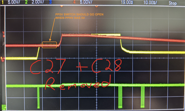

  • From your scope captures, the PP5V switch is opening for the 9V contract because when PPHV drops, VBUS drops with it. If PP5V switch was closed still, VBUS would not drop. In our firmware, PPHV closes before PP5V opens in the TPS25750 when transitioning from 5V to 9V contracts. RCP may have failed causing PP5V to see the 9V. Once we open the PP5V switch, we have no way of discharging the 9V on PP5V causing OVP.
    After re-reading Alex's post, I think I understand why removing these caps might fix the problem if it is indeed intentional that PP5V opens after PPHV closes. (Open = stopping current, Closed = Allowing current).
    Removing cap C27 and C28 makes the PP5V bus drop quicker after its connection is opened, but this doesn't change the overall behavior. Nor does it explain why Alex has a working CHG-EVM while Richard and I do not.
    Nate

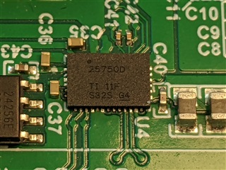

    The exact chip I have on my CHG-EVM is: 25750D TI 11F S32S G4.  My board serial number is 7904700013 and was purchased from Digikey.
    Alex, are you able to purchase one of the EVMs with similar serial number as mine and try out your binary on it?  You being able to debug on the same revision board would certainly speed up the process. I suspect there is an issue with the online tool for creating binaries that is preventing successful operation of the new boards.

  • Ah, I missed the serial number on the back.
    As stated before, the exact chip I have on my CHG-EVM is: 25750D TI 11F S32S G4
    And the board serial number is: 7904700030 also purchased from digikey.

    4. Nate tested the CHG EVM behavior with C27 and C28 caps removed, but PP5V voltage was still ramping with PPHV.
    A couple comments from me:
    1. The reason you see the CHG EVM cycling is because the TPS25750 is seeing OVP on the PP5V path when it ramps to 9V. It will not continue to operate under these conditions.
    2. It is correct behavior for PPHV switch to enable before PP5V switch is disabled. The TPS25750 requires power from PP5V to control the gate drivers for PPHV. We use RCP to prevent PPHV voltage from being seen on PP5V when the "make then break" power path switch operation occurs.
    3. The reason we proposed removing some capacitance (C27 and C28) was that high capacitance on PP5V could cause RCP to fail. Since the TPS25750 relies on RCP to prevent PPHV voltage from being seen on PP5V during power path switches, a failure of RCP could have been the issue. High capacitance would mean slower charging of the caps, which will cause the TPS25750 to see RCP later, potentially too late. Once the PP5V switch opens with 9V already seen, we do not have a way of quickly discharging it, so OVP would be triggered.

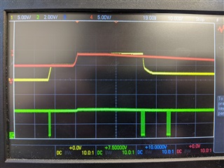

    OK, I have tested your latest json.
    If I select PDO1 to provide 5V output, VBUS is at 5V and PS_RDY is output and all is stable.  Of interest is the fact that PPHV has 9V generated by the BQ during this state.
    If I select PDO2 to provide 9V output, the following is see as before with the repeating cycle:
    If I select PDO3 to provide 15V output, the repeated cycle is done again:
    Note, my board does not have the PP5V capacitors removed.
    Richard

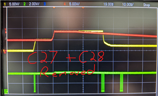

  • Hi Alex,
    To be thorough, I have my CHG-EVM in the following configuration:
    • JP1 populated, JP2 not populated, JP3 not populated
    • J2 connected to a 8.4V bench supply ( The charge voltage you defined in the "USB_PD_CHG_EVM_Test.json" config)
    • C27 and C28 are still removed on my CHG-EVM.
    To flash the configuration to the EEPROM I am using an in house developed script to emulate the Tiva chip on the TPS25750EVM. This script also implements the flash verification step that the customization tool performs post flash, and has also been tested extensively. All that to say, I am directly flashing from the "TPS25750 Application Customization Tool" v7.0.4.6.
    When loading and flashing the provided "USB_PD_CHG_EVM_Test.json" into the customization tool I followed the below steps:
    • Open a fresh instance of the customization tool as an administrator.
    • Click "New Configuration" to ensure there weren't any settings saved from my previous session.
    • Click "Browse" right below the "Export Settings" button and navigated to and selected the downloaded "USB_PD_CHG_EVM_Test.json" file.
    • Clicked "Flash To Device From Current Configuration" at which point I monitor the I2C traffic on the bus with a TotalPhase Beagle and see the following:
      • The EEPROM is erased with 0xFF across all of its registers.
      • The EEPROM is flashed with the generated data.
      • The EEPROM data is verified by reading the registers back to the application customization tool.
    • I then power cycle the device by turning the bench supply off and on again. I also verify the power cycle by monitoring the I2C traffic between the EEPROM, TPS25750, and BQ25792.
    • Then I plug in a 9V sink device into the USB C port.
    The behavior of this configuration is the same as before. RED = PP5V, YELLOW = PPHV, GREEN = I2Cm_SDA.
    Hope this helps,
    Nate

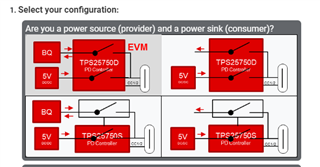

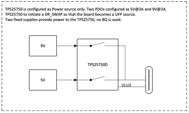

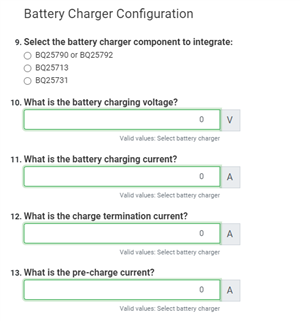

    An other option that I would like to investigate further has the following power diagram for the TSP25750:
    Do you know if I can configure this through the online GUI and generate a bin that will work?
    Richard

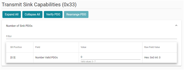

  • Hi Richard,
    Yes, your desired behavior and setup is possible.
    You can make the following changes in the GUI configuration:
    1.) Leave the config as below:
    2.) Do not select a battery charger component and set charger voltage/current to 0.
    3.) Change the GUI to advanced configuration. Modify the TX Sink Capabilities register to have 0 sink PDOs.
    I am not 100% positive of the DR swap initiation. If you find the PD does not do the DR swap to UFP, I can provide a json project that does.
    If you wish to test this, I recommend using the TPS25750 EVM instead of the USB PD CHG EVM. Using the TPS25750 EVM, you can hook up the 9V supply to PPHV using any of pins 1-4 of the J3 header. You can also test this with the USB PD CHG EVM by hooking up the 9V supply to the PPHV test point and flashing the binary when the board is powered using the type C connector only.

    I followed your directions for the source only instructions as you provided.  The Generate Full Flash Binary button never gets enabled and thus I cannot generate a binary file.  The GUI must be doing a check on the EVM selection in step #1 above;  as soon as I check the one to the right of it I am allowed to generate a binary file.  If you can provide a json that will allow me to generate a binary that would be great.
    Richard
  • Hi Richard,
    It seems like this is a GUI limitation. I can provide a binary with your settings. Do you already have a JSON file you were trying to use to generate the binary? I am also still working on making a fix for CHG EVM sourcing issue. Progress has been made and it can source >5V now, but the PP5V ramping issue is not fully resolved. I will update you again when I have the fix.

    Thanks for the feedback on the initial >5V issue.  I am sure it is taking quite a bit of effort on a number of fronts to get all the pieces working together.
    The JSON file for the fixed (no BQ connected) 5V in and PPHV = 9V with DR_SWAP as shown in my diagram has contents:
    {"questionnaire":{"version":"7.0.4.7","answers":[0,1,0,0,1,2,1,null,1,null,null,0,0,0,0],"options":{},"configID":"0000","vendorID":"0000"},"configuration":{"data":{"selected_ace":[{"register":6,"data":[0,0,0,0,0,0,0,0]},{"register":22,"data":[10,48,48,77,0,0,0,0,0,0,3]},{"register":50,"data":[2,168,42,44,145,1,38,44,209,2,0,44,177,4,0,44,65,6,0,0,0,0,0,0,0,0,0,0,0,0,0]},{"register":51,"data":[0,44,145,1,16,44,209,2,0,44,177,4,0,244,65,6,0,69,65,6,0,0,0,0,0,0,0,0,0]},{"register":92,"data":[48,0,0,0,0,0,0,0,0,16,0,0,0,0,0,0,48,0,0,0,0,0,0,0,0,12,0,0,0,0,0,0,0,0,0,0,0,0,0,0,0,0,0,0,0,0,0,0,0]},{"register":117,"data":[0,0,0,0]}]}}}
    Sorry I did not figure out how to attach the actual json file to this post so just inserted the code.  Looking forward to testing the binary on my board.

  • Hi Richard,
    Please see the full flash binary attached.
    https://e2e.ti.com/cfs-file/__key/communityserver-discussions-components-files/196/TPS25750_5F00_DualPath_5F00_SourceOnly_5F00_UFPPreferred_5F00_NoBQ.bin
    Config:
    PP5V and PPHV Source Only
    5V/3A Source PDO on PP5V, 9V/2A Source PDO on PPHV
    DRP State Machine w Auto Initiation of DR Swap to UFP
    USB2 Support Only
    No BQ Part Needed
    Alex

    Thanks for sending over the "TPS25750_DualPath_SourceOnly_UFPPreferred_NoBQ.bin"
    I have tested it and found that it still is looking for the BQ25792 to be on the i2c bus.  Besides that I can see that that it is presenting correctly to the USB Type C port.  With the DR swap support as expected.  For full functionality I still need to write some microcontroller code to make the board more functional.
    Currently I have received my own PCB assembly with the BQ25792 and TPS25750 designed in.  My preference for this PCBA is still to use the TPS25750 to manage the BQ25792 output voltage generation for VBUS, and would like to use the GUI to generate the appropriate binary. Would you be able to provide an update as to how you are making out on the GUI fix and release?
    Richard
  • Hi Richard,
    I am not sure why the PD is still looking for the BQ part as all I2C events should have been disabled. However, it should not be an issue.
    For the fix, we are still working on this and are between a firmware and GUI fix. We will update you next week on progress.
