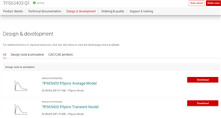

I want to test TPS65400 in my design, so i need to use simulation model of PSpice.
I will do the simulation about gain/phase margin in AC Analysis.
There is no matching model on 'PSpice for TI', so I downloaded from your site.
But I couldn't check the completion message of my simulation data.
Maybe,, I think I didn't add a model library accurately.

1) Do you have a available PSpice Simulation model of TPS65400?
     As I check on your website, you usually give a guide that use a EVM Board for margin simulation.
     And in a webench, as i know, there is a result about 500kHz switching frequency only.
2) May i receive the guide or  manual about How to Add the library on tool accurately.

    If you want to use "PSpice for TI" to run the TPS65400 PSpice Transient Model, please make the following modifications.
    "PSpice for TI" currently cannot run the TPS65400 PSpice Average Model for AC Analysis, while you can use Cadence PSpice to run it. We are trying to modify it, but there is no result yet. Once it can work, we will give you feedback in time.
    To run the TPS65400_PSpice_TRAN.pptx
