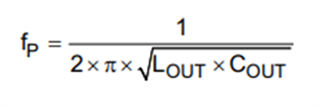

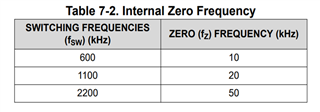

Datasheet:
Plugging 4.7µH & 1µF in the calculator, with 60% derating, Fsw = 1.1MHz, results in "GOOD" stability, while the calculation with the datasheet the capacitor should be at least 15µF. Can you comment on that?

  • Datasheet calculation is very straightforward with the equation I listed for the pole frequency. With L= 4.7µH and C=15µF, the pole is at the limit with 19kHz.
