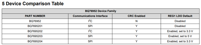

    You might also check the device comparison table in the datasheet (attached below) to see if the device version that you have is I2C by default and if it defaults to CRC as well.

    I am using BQ76952 I2C without CRC and REG1 disable.
