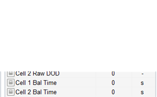

I conducted several cycle tests and found that the cell balance time is updated before the discharge starts.
What parameter is it confirming for the update? Is it the voltage difference between the two cells, or something else?
Additionally, I would like to inquire about the approximate current for battery balancing.
Yan-Yu, Tuan

  • Hi, Jose Couso
    I understand that battery balancing will not be initiated during discharge.
    What I want to know is how the battery balance time is updated.
    Please assist in providing an answer.
    Thanks!
    Yan-Yu,Tuan

  • Hi, Jose Couso
    I understand the calculations in TRM.
    However, I'm more interested in how to determine in BQ Studio when the cell balance time is updated.
    What conditions trigger the update of the cell balance time?
    Is it voltage difference, capacity, or some other criteria?
    Yan-Yu,Tuan

  • Hi, Jose Couso
    1. Where can I find the capacity and SOC of each series-connected cell?
    2. How can I determine the value of dQ?
    thanks!
    Yan-Yu,Tuan

  • Hi, Jose Couso
    May I inquire if it is possible to obtain the following parameter values from a picture or any other source?
    1. CellnDOD
    2. CellLOWEST_SOC DOD
    3. CellnQMax
      Your response is appreciated.
      Thanks!
      Yan-Yu,Tuan
  • Hi Yan-Yu,Tuan
    The gauge will first calculate the amount of charge needed to bring the cells to full. So the cell with the lowest DOD is the highest charged.
    Then the gauge will calculate the dQ by taking the difference between the maximum charged cell and lowest cell.
    So the formula is:
    dQ = (Cell_lowest_DOD - Cell_highest_DOD) * Qmax_cell_lowest_DOD
    Cell_lowest_DOD is the cell with higher voltage
    Cell_highest_DOD is the cell with lower voltage
    Qmax_cell_lowest_DOD is the Qmax of  the cell with the higher voltage.
    This parameters should be able to be used for these.
    Jose Couso
