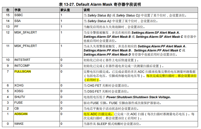

1, Does the I2C communication interface of BQ76952 support clock stretching feature? In other words, when the BQ76952 acts as a slave, can it force the host's clock to slow down the data communication?
2, Settings: Alarm: Default Alarm Mask register field of BQ76952: How long is the interrupt refresh time of FULLSCAN and ADSCAN?
Bit 7 FULLSCAN Full voltage scan completed. The necessary multiple ADC scans have been completed to collect complete voltage measurement loop data (including cell voltage, pin or thermistor voltage, etc.). This bit (when enabled) is set every time a full scan is completed. Bit 1 ADSCAN Voltage ADC scan completed. An ADC scan has been completed (cell voltage is measured on each scan). This bit is set (when enabled) every time a scan completes
