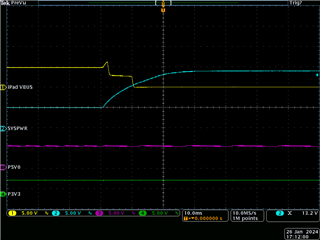

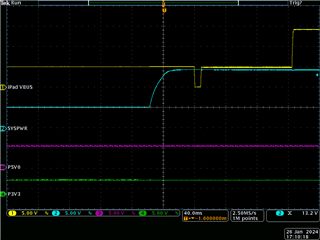

The issue I am seeing is that when the USB power adaptor is attached, the correct behaviour is normally seen with the Host swapping to being charged and the data connectivity of the Host to the USB Mass Storage device is maintained uninterrupted. However, sometimes it gets into a state where incorrect behaviour is seen with the data connectivity from Host to USB Mass Storage device is lost when the Host swaps to being charged and then the USB Mass Storage device re-mounts automatically a couple of seconds later. It seems to remain in this odd state but if a "PD Hard Reset" 4CC command is issued to the Host PD Controller via I2C, the normal behaviour is restored.
Unfortunately, if I put a PD protocol analyser (a Lecroy T2P) in between the Host and its PC controller, it seems to change the behaviour itself, so I am unable to check what PD messaging is going on to try and debug the issue.
I have attached a scope screenshot of the "correct" behaviour and one of the "incorrect" behaviour. I have also attached the TPS65987D Application Customisation Tool project file for the Host PD controller.
There appears to be no issue with continuity of power for the hub and muxes in the USB data paths so I suspect that the Host is temporarily switching data role from being a DFP to a UFP when the power role swap from source to sink occurs.

    What seems to be happening is that when the SYS_5V power rail is just powering the on-board hub circuitry, the "correct" case occurs as I originally posted in the "correct" scope trace capture, but if I load the DS2 5V port say with just 200mA it seems to cause the "incorrect" behaviour as I originally posted in the "incorrect" scope trace capture.
    It seems that on inspection of the Host VBUS waveform for the "incorrect" case, the Host VBUS voltage seems to be following the increase in SYS_PWR voltage until presumably an over-voltage protection event occurs and opens PP_HV1 switch, as if PP_HV1 is not reverse blocking.
    I have re-captured these two cases of behaviour with GPIO18 configured with the "PP1 Switch Event" in order to see state of the switch on the scope, and configured the "Interrupt Mask for I2C1" to enable the  "Error: Power Event Occurred" to also display on the scope. I have attached these "correct" and "incorrect" scope traces.
    USB power adaptor attach cable - monitor error IRQ - low load on SYS_5V.png - shows expected correct behaviour
    USB power adaptor attach cable - monitor error IRQ - higher load on SYS_5V.png - shows the "incorrect" behaviour with PP1 switch state and I2C interrupt configured for "Error: Power Event Occured".
    USB power adaptor attach cable - monitor error IRQ - higher load on SYS_5V - zoomed.png - zoomed in version of the "incorrect" behaviour
    The I2C interrupt trace activity seems to suggest that an over-voltage protection event has occured due to SYS_PWR forcing the Host VBUS and PP_HV1 switch is subsequently opened.

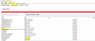

  • Hi Gerry,
    I don't immediately see any settings to change or manipulate these values or operations. What may help, can you:
    1. Go into debug mode in the Application Customization Tool/GUI
    2. Proceed to the following section:
    3. Run your processes again, and check the above.
    This may help provide some insight. It may also help to check the other sections for events which correspond to high voltage or overcurrent. These can be found in the TPS65987D TRM linked here and by searching for 'overcurrent' or 'highvoltage', or by using the ACT/GUI and while in debug mode and debug registers searching for the above accordingly.

    Is it possible after you and while you see this issue, can you go into the application customization tool/GUI while connected to the device and grab some debug logs for me? You can do this through the tool by going to the top tab labeled 'Debug' then going to 'Debug Mode'. After selecting this go to the top tab of 'Debug' and select/use the option for 'Take Snapshot'.
    Field
  • Hi Field,
    Many thanks for your recent comments.
    I have not yet had a chance to test your iPad configuration (and replace the iPad in my set-up with a 2nd EVM), however will do so next week.

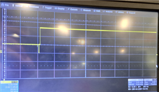

    Meanwhile, the reverse blocking issue we're experiencing continues. I have increased the PSU voltage slightly to overcome the diode/distribution losses, and verified the voltage being received by the iPad is 15V (reported as 15.0V at the iPad, reported by the in-line power meter, please see attached photo of my set-up). In this configuration the EVM is directly passing through the 15V from the PSU to the PP1 SRC path. The bench PSU current limit is significantly higher than the required current (the source PDO to the iPad is 0.5A, the electronic load is set at 0.5A and the PSU current limit is > 2A.
    I have captured and attached snapshots as requested. These are configured as follows:
    1.zip - PSU off, iPad acting as SRC (EVM as sink), electronic load off. No issues observed.
    2.zip - PSU on, iPad acting as SNK (EVM as sorce), electronic load off. No issues observed.
    3.zip - PSU on, iPad acting as SNK (EVM as sorce), electronic load on, 0.5A. Reverse blocking issue (and resulting over-voltage/link reset issue) observed.
    I would be interested to know if you can determine anything from these files.

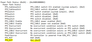

  • Hi David,
    As has been discussed it looks like the RCP is active, but only on PP_2, which is only set for the 5V source. (Assuming you are using EVM as 5V 15V sink source with iPad.pjt) and this could be what is causing what is seen.
    Could you try using the following .bin file provided below (when using your current setup of the EVM + iPad) and let me know if it alleviates anything that is being seen? I developed this from the .pjt I mentioned above, if you are using a different .pjt with the EVM, and seeing this issue please let me know. This may prove unsuccessful but is worth looking into:
    https://e2e.ti.com/cfs-file/__key/communityserver-discussions-components-files/196/David_5F00_E2E_5F00_1_5F00_05FEB.bin
    After discussing this with another expert, it is believed that perhaps the levels on VBUS when trying to source from the other side are greater and is causing this issue. One of the ways mentioned was to control the levels on VBUS when this is occurring or through the timing as the source supply is starting to ramp up and thus trying to swap roles. But the .bin file above, or some changes to your .pjt that I can guide you through, or testing with another EVM will help shed some more light on the issue.
    Field

    It is odd that Reverse Current Protection is only active on PP_2 in the debug log above. We certainly require RCP on PP_1 - the case we are concerned with is when PP_1 is acting as a SNK (5V supplied from iPad VBUS conducting through PP_1 to SYS_PWR), and SYS_PWR is then raised above 5V by an external source.
    You are correct in your assumption that I'm using project file 'EVM as 5V 15V sink source with iPad.pjt', provided above.
    I have run the binary 'David_E2E_1_05FEB.bin' in my set-up - the behaviour has changed and I believe the reverse current issue is no longer present. Please see attached screenshots from scope - there is no longer evidence of an over-voltage condition on VBUS (in comparison to the previous screenshots that I provided). The iPad does now fail to establish a steady-state SRC contract from EVM however - it appears to oscillate between SNK and SRC states (see attached screenshot).
    It would be useful if you are able to guide me to configure the RCP feature correctly for our application via the Application Customisation tool - and if there is anything you have adjusted within the .bin file supplied that is preventing us reaching a steady-state SRC contract.
    Please let me know if there is anything further that I can provide.

    Above you can see the similar behaviour, although this is from just sourcing (no swap from sink to source). I'll re-test though and check the debug logs to see if the RCP is active here as well to ensure it is similar. But when editing the configuration, to change it into the binary file provided I did not see this, and is the result I provided earlier.
    Would you be available for a call to go over this? If so my email is f-tolson@ti.com. This way I can ask you some questions(mainly the ones from below or other that I may have between then), show you with some of things I am looking at, possible solutions, etc.
    • Is this first one with the load attached too?
    • Is the second scope shot from turning the device off, unplugging the iPad and starting again? Or are you disconnecting the 15V source (so the device would want to sink, and iPad would want to source again?) and then reconnecting?
    Field
  • Hi Field,
    Many thanks for your response.
    It is encouraging that you are observing what appears to be similar behaviour.
    In my tests I observe the RCP issue when the EVM is acting as a SINK (reverse current flow is then observed from SYSPWR -> iPad VBUS, as per plot #2, above) - this happens prior to the Power Role Swap being commanded. In our application we have 3x TPS65987D instances connected by a common SYSPWR bus - we therefore require the TPS65987D devices to act as ideal diodes when operating as SINKs (i.e. supplying the common SYSPWR bus).
    In both the plots provided above the electronic load was attached an enabled (constant current, 0.5A). I cannot explian how the presence of the electronic load would influence the system, however the system behaves as expected when the load is disabled.
    There is some dependancy on the order of events. Plot #1, above, showing the desired behaviour was captured from a completely cold start (iPad connected, then 15V PSU enabled). To achive plot #2, the iPad remained connected, but the 15V PSU was disabled and then subsequently re-enabled. The electronic load was enabled throughout. It almost appears that the RCP is behaving correctly from cold-start, but is then somehow being disabled. I can conduct some further experiments to establish more information here.
    It would be highly appreciated if you could join a call to discuss this - I will contact you via e-mail.

  • I have not been able to test the fix or confirm its origin. However, here is a project file that you can load to your device to see if the issue is resolved.
    I believe the issue is with how the RCP mode is handled after an FRS, so I have changed this value in the attached pjt file. This field isn't user configurable, however the value is indeed changed in this attached pjt file, so that if this fix works, you can continue to make changes to the pjt file to meet any future needs/changes you might make.
    I will continue testing tomorrow, but I thought in the meantime you would at least like the ability to test it yourself in the interim.

  • Hi Conner,
    Many thanks for providing this updated .pjt file - I have tested with this today and unfortunately the issue is not resolved (I'm seeing waveforms equivalent to those a few posts above). I programmed the file using the Binary -> Flash from current project option.
    It does indeed seem like a configuration/firmware issue, as the Power Path behaves correctly for the first PRS cycle (folloowing power-up), but fails on future cycles (i.e. after an FRS event has occured).
    Grateful if you are able to continue looking at this and hopefully provide a revised configuration for me to test.

  • Under "General Settings" -> "Firmware Base Image", what .bin file is listed?
  • Or "Firmware Version: "
  • Base image as per attached screenshot.
  • Can you send me the binary you made for the most recent project I gave you (1401.EVM as 5V 15V sink source with iPad.pjt)? I just want to compare it to the binary I made based off of it to confirm they are identical.
