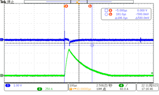

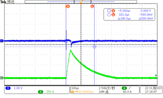

    When I was using SCD, I used the method of external short circuit to test SCD, and I found that there would be a phenomenon of SCD failure. When I set the external short circuit, it would automatically shut down FET when my protection time was greater than 90us, but it would not show fault. On the contrary, everything was normal when the protection time was less than 90us. May I ask what the reason is?

    Regarding the SCD, can you capture a waveform of the voltage between the SRP and SRN pins as close to the pins as possible and make a note of what the SCD settings are? That way it will be easier to determine what the device is actually seeing and if it should trigger SCD or not.

    This is the waveform of SRN, voltage and short circuit current at both ends of SRP that I intercepted by using external short circuit. The first picture is the waveform with SCD protection time greater than 70us, and the second picture is the waveform with SCD protection time less than 70us,When the value is greater than 70us, the BQ will report a fault. However, both methods are protected by BQ, only the difference in fault reporting

    Protections:SCD:Delay controls how long the measured current has to exceed the threshold for a SCD fault to trigger. If the measured current drops below the threshold before the time is up, then the fault will not trigger. You may want to check in the event where the SCD does not trigger but the FETs turn off that another fault has not triggered instead.

    1. As you said, my SCD protection may be caused by too long protection delay time, but as shown in the oscilloscope waveform, BQ has been protected when SCD occurs, but I can't see the fault display in A-C when the protection delay time is greater than 70us, my SCD threshold is 200A, is the threshold set too large? Or some other reason.

    1. You may try capturing the SRP-VSS and SRN-VSS voltages on a scope to see if the 0.5V recommended limit is being exceeded. In some cases this has been observed to cause the FETs to turn off.
