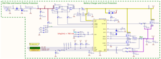

I am using BQ24725A BMS ic for industrial purpose but it is getting 3.3 volt at battery terminal and not getting charge the Battery due to under voltage
I have same design use as per data sheet.
Please help me.

Hi Vivek,
Thank you for reaching out!
Could you please provide more information on your battery charger design?
1- Are you observing this behavior on an EVM?
2- What is the input voltage/current?
3- Could you provide the schematics?

Hi Aya,
Please find below Answers:-
--Same used EVM
--12V/3A,16/3A/19V/8A
--Please find ref. Schematic.

Hi Vivek,
The BQ24725A is an SMBus controlled battery charger. The SDA and SCL pins should be connected to the SMBus data lines from the host controller.
See section 8.5 Register maps for the setting charger options. There are 6 battery charger commands that are used to configure the charge current, charge voltage, and input current limits.
See my comments below in regards to the schematic:
1- I don't see any capacitance on the system (see below for example schematic from datasheet):
2- Connect 10kOhm pull-up resistors on the SDA and SCL pins according to the SMBus specifications instead of 2.2kOhm (which you currently have)
Please let me know if you have additional questions/concerns.

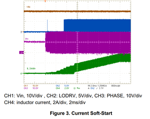

Hi Aya,
We are able to change the drive voltage and current and switch the voltage from Vin to SYS and to Battery voltage. but switching frequency is not coming on battery inductor.
please suggest.
Vivek Kumar
Hi Vivek,
Could you please provide waveforms similar to those below?
(refer to Section 6.7 Typical Characteristics in datasheet)

Hi Aya,
We couldn't provide waveforms to you because of we have only 2 channel DSO. Anyway my issue is resolved after purchase the EVK module.
There are more than two difference found from EVK to datasheet.
I would like to thanks for your support.
