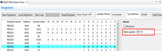

1. Use a 70W USB-C Power Adapter PD for charging, with charge current (REG03) set to 3200mA and term current (REG09) set to 80mA. The cut-off current read by the charging terminal BQ4050 is 182mA
Charging current 3200mA, cut-off current 182mA
charge current  Set 3200mA
term current set 80mA
Using a 70W USB-C Power Adapter PD for charging, set the charge current (REG03) to 1000mA and the term current (REG09) to 80mA. The cut-off current read by the charging terminal BQ4050 is 77mA

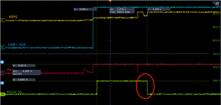

2.During the charging activation process, when the charger is first connected, the LDO voltage REGN of BQ25798_ 5V will suddenly drop to 0V, making it impossible to start charging. The second time it is connected to charging, it can be charged normally. May I ask what conditions can cause a REGN of BQ25798_ 5V off?
  • Hi Gabriel,
    Regarding 1, in order to improve current measurement accuracy, most of our NVDC chargers turn off part of the BATFET at specific, lower charge current setting.  This makes the BATFET more resistive (lowers efficiency) but improves measurement accuracy.
    Regarding 2, I have not seen this behavior before.  Can you provide the test condition, VBUS? VBAT? ICHG? ISYS load? Also, it appears that the converter is still switching since VSYS is high, following the dip?  Is the converter switching?
