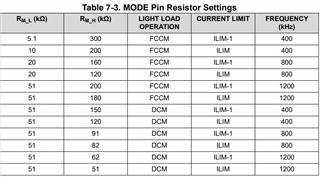

I have a question about TPS56C215 mode pin resistor setting.
According to datasheet, When I set  FCCM, ILIM, 1200kHz mode, the Rm_H is 180k and Rm_L is 51k.
But When I set the same mode with WEBENCH power designer, it use different value with datasheet.
Please let me know it is correct.
