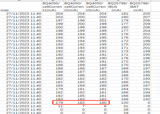

            Set BQ25798 charging current to 3200mA and cutoff current to 80mA,. The measured cut-off current is 182mA, which cannot meet the specified standard 80±20%mA. and When I set a relatively large charge current, the accuracy of the charge cutoff current will be reduced. Does TI have any documentation to explain whether 182mA cutoff current is reasonable when we set 3200mA charging current and 80mA charging cutoff current?

              When I set the charging current to 3.2A and the charging cutoff current to 80mA, the accuracy of the charging cutoff current will be worse than 80mA±20%. So I need to define the accuracy of the charging cutoff current to what is reasonable? (I used the data of BQ25798 or BQ4050 log, and the measured charging cutoff current reached about 180mA, which exceeded the cutoff current specification defined in the datasheet of BQ25798.) I could not find the corresponding documents to prove whether my test data was reasonable.

                But my charging current is 3.2A, not less than 1A, in this case set 80mA cut-off current can also achieve 80mA±30% accuracy?
