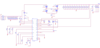

hello,
I am currently working on a voltage regulation circuit using LM5176PWPR that can handle approx. 24VDC at 6A
Kindly find the design which we have implemented
when we connect the load of capacity approx 3A the inductor started heating upto 125 degree.
Can you please provide a solution for this issue?
