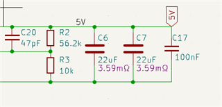

    3. The 5V rail is configured to 4.98V output, not 5.3V in your note below.

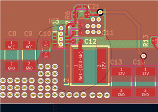

    For layout,
    1. Below SW node size doesn't need to be that large, you could decrease it to inductor pad size. Generally SW node is noisy node, we don't want it be very large.
    2. You can move Vout sensing traces from Layer2 to Layer3, to avoid Layer1 SW disturbance.

    2. Value of Rfbt (5.3V) corrected on the footprint. 56.2kOhms
    3. SW layout for 12V buck corrected.
    4. Feedback paths routed to Inner layer two.
