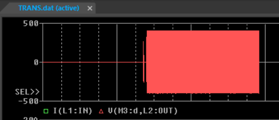

I modified the transient simulation and evaluated the transformer LS input to the design. I have attached the modified design file for your reference. The primary turns ratio was changed to 5 similar to your design.
I reran the simulation and evaluated the voltage across the H Bridge and transformer.
I zoomed in on the voltage across the primary of T2 and the voltage across the H Bridge output (L2+T2 primary).
The voltage applied across L2 and T2 primary was 410 V and the voltage across T2 was 239V. The voltage is being divided down when it should not be.
L2 = 26 uH, while the Lm of the transformer is 2.6 mH, with LLeak of 7.5 uH. Even if there were and inductance divider this voltage would be 410V*2.6m/(2.6m+33.5uH) = 404.8 V roughly.
There appears to be something wrong with this model and I am going to move it to the TI PSpice forum for further support.

THey are unable to reproduce the problem.
Per their correspondence:
As described in the problem statement that the voltage across T2 was 239.
I checked it at my end and it does not seem to be 239 rather it is 400V which is expected as per the calculations shared by you.
Below are the snapshots for your reference, let me know if i misunderstood anything and we can have a call to discuss it further. I probed the voltage across T2 primary and the result is
Cursor measurement for T2 primary is 400 as below
We might need to arrange a call to resolve the source of the difference.
