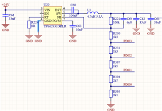

Hi, I need a buck converter, to create a USB-C PD voltage source in range 5V to 20V, 3A of current(2,5A for 20V). I create a chematic with a TPS62933 shown bellow, but I am not sure if this driver will work fine in that conditions.
The additional PD Driver set an output voltage by connecting a PDOx nets to gnd. I chose TPS62933 becouse it is quite cheap, small package and has maximum PWM of 98%, which can help to achive 20V from 24V input. But I am worry becouse of WEBENCH can't create a simulation with this driver when I set an output voltage to 20V, showing an error that phase margin is out of range, but maximum output voltage should be 22V. Another case I am worry is UVP and/or OVP when PD driver change an output voltage. Does TPS driver stop working and restart? If yes, I have to find other chip.

    1. Surely our device could support up to 22Vout_max, but thermal may be a problem if output power is high.
    See this e2e post, previously I measured tps62933 EVM board (2 layers) thermal, 24Vin-19Vout-3A-500kHz, device was about 140C which was too high.
    Is your PCB board size big? How many layers? Is your board thermal dissipation good or bad?
    2. If thermal won't be a problem, I need to review your external components design, I can help to do some simulations of four Vout (5/9/15/20Vout) loop stability.
    3. If thermal could be a problem, I strongly suggest you to evaluate TPS56837H, this part is designed for TypeC PD application.
