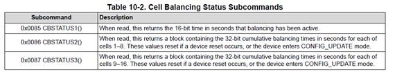

Hello TI Team,
I am working on:
BQ76952EVM
BMS029B

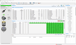

We are having issues with Testing Cell Balancing Feature on the Evaluation Board. I am sending a config file (.gg file) which is configured to measure 15 cell voltages, measuring 3 cell temperatures (using ports TS1, TS2 &TS3 pins configured as thermistor inputs to measure cell temperatures) and autonomously balance cells (Balance 15 cells at Maximum in parallel).

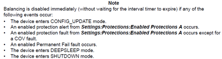

I checked all the parameters which can block Cell balancing as mentioned in the BQ76952 reference manual:
None of these parameters/faults/protections/modes are triggered which can be verified with the log file attached below.
We tried Autonomous cell Balancing both in Normal as well as in Sleep mode and none of them gave me an indication on the Alarm status (CB signal - enabled if cell balancing is Active). We also verified by checking the 'Active cells Cell Balancing ' [0x0083 CB_ACTIVE_CELLS] subcommand which displays the address of cells being balanced. Also, can you inform me about any Gates that I can probe to check if Cell Balancing is active or not. We also tried host control cell balancing (writing 0x0083 CB_ACTIVE_CELLS() & 0x0084 CB_SET_LVL()) which responds in the same manner with no change while reading 'Active cells Cell Balancing ' [0x0083 CB_ACTIVE_CELLS] subcommand. It displays a zero value even after I write it with a specific cell address. Can anyone please verify my sequence and point out if you think I am doing a step incorrect?

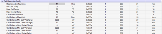

Settings	Manufacturing	Mfg Status Init	0050	Hex
Settings	Cell Balancing Config	Balancing Configuration	17	Hex
Settings	Cell Balancing Config	Min Cell Temp	-20	°C
Settings	Cell Balancing Config	Max Cell Temp	60	°C
Settings	Cell Balancing Config	Max Internal Temp	70	°C
Settings	Cell Balancing Config	Cell Balance Interval	20	s
Settings	Cell Balancing Config	Cell Balance Max Cells	15	Num
Settings	Cell Balancing Config	Cell Balance Min Cell V (Charge)	3000	mV
Settings	Cell Balancing Config	Cell Balance Min Delta (Charge)	30	mV
Settings	Cell Balancing Config	Cell Balance Stop Delta (Charge)	5	mV
Settings	Cell Balancing Config	Cell Balance Min Cell V (Relax)	3000	mV
Settings	Cell Balancing Config	Cell Balance Min Delta (Relax)	30	mV
Settings	Cell Balancing Config	Cell Balance Stop Delta (Relax)	5	mV

For Specifics, here is the snippet of my Cell Balancing configuration and all the parameters associated with it:
I am also attaching a log file which gives no indication of the cell balancing statuses.

    Did you configure the cell balancing as detailed in Section 3 Stand-Alone Balancing Algorithm and Settings of the Cell Balancing With BQ769x2 Battery Monitors application note?
    Mind uploading the log file as a separate file (Insert>Image/video/file), I would like to open it on excel to better understand the log.
    You can use CB_ACTIVE_CELLS() to see which cells are being balanced, if you want to see it externally, you'd need to use an oscilloscope probe on the pins directly, the cell balancing would look like Figure 2-3 of the application note mentioned above.
