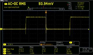

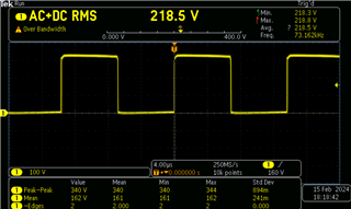

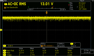

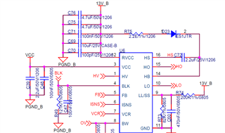

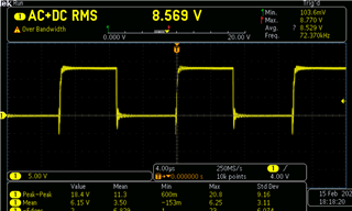

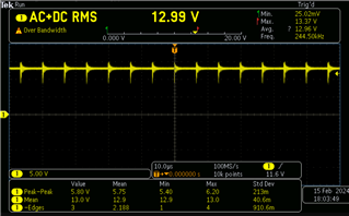

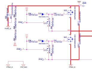

How to arrest the RVCC noise in the UCC256404? Noise starts whenever the switching starts Check out the below captured waveforms and circuit.
VCC: 18V
RVCC: 13V
LO Output
HO Output:

Hi Nishanth,
Its a switching noise. Could you use the tip and barrel method given in the following link while measuring the voltages
Power Tip #6: Accurately Measuring Power Supply Ripple - EE Times
Manikanta P
Thanks for the support. How to reduce the Negative Glitch in the falling edge of the LO output.

Hi Nishanth,
As I mentioned, it could be switching noise. By using proper probing techniques, it should go away.
