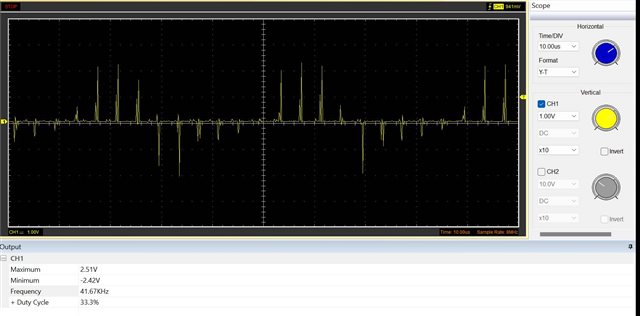

  • Hello Eric,
    I changed my inductor to 53 uH. Unfortunately, I couldn't get a good result. Now, the output is 2.5 volts and when I connect to load(R=6.8ohm), the inductor creates a noise very loudly.
    Please help me to find my mistake to obtain a good result (24v).
    I checked all absolute maximum ratings of the LM5116( based on page 5 of the datasheet ). I think all of them are in range roughly. (Pdf file attached)
    All output signals are attached .
    Leila
    Result comparison.pdf
  • Hello Leila
    Looks like the converter is unstable now and you need to adjust the loop compensation component values using the Quick Start calculator.  https://www.ti.com/lit/zip/snvu051
    By the way, why did you change the inductor value to 53 uH?
    -EL

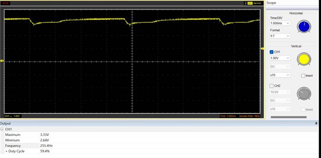

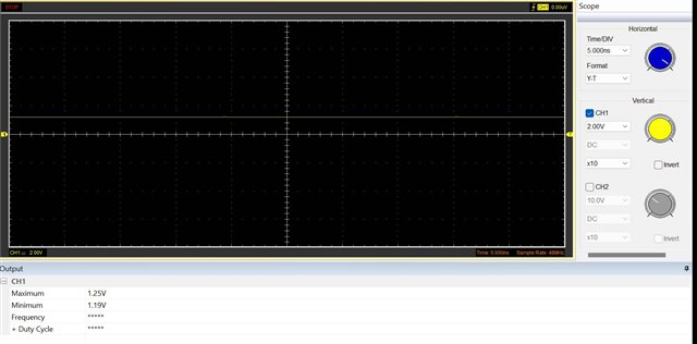

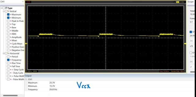

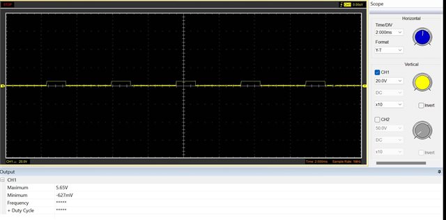

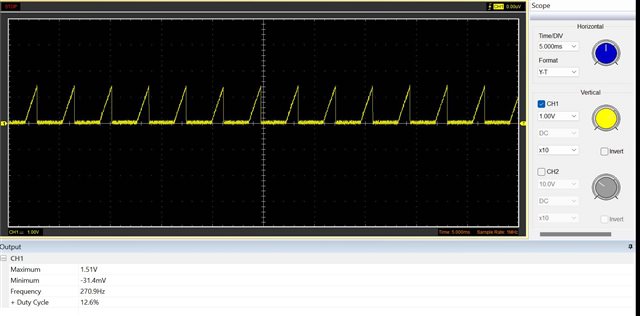

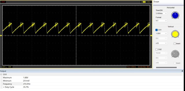

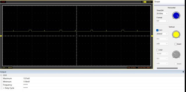

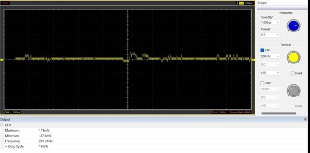

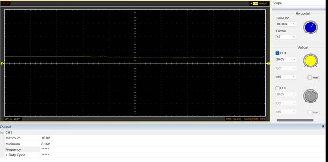

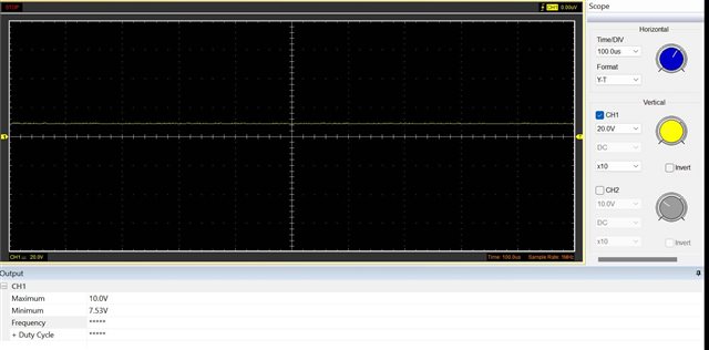

  • Hello Eric,
    I changed my board and I made some improvements like changing the Inductor to 57 uH, the compensation loop to the (R=111K, C= 560pf), and RAMP components( R=128K, C=1300pf). As you can see the output improved but It has ripple( attached ). Then I started to check other test points like VCCX ( I should mention that I didn't use external VCC) and also SW( attached ). During the check of different test points like RT, I don't know, what did I do so that I lose suddenly the output.
    I have two question:
    1. The level of the VCCX is out of the range that recomend in the data sheet, Is it okay?
    2. How can I check the LM5116? Because I tested the two MOSFETs, diodes and Inductor. They are okay.`
    Now I am doubt between the PCB and LM5116.
    Thank you,
    Br, Leila
  • Hello Leila
    1, The abs max of VCCX is  only 16V. The device will be damaged if VCCX>16V
    2. Please follow this
    1. Replace the IC
    2. Set the power supply current limit ~0.1A-0.3A
    3. Gradually increase VIN without load
    4. Check these pins one by one step by step  EN, UVLO, VCC, RT, SS, COMP, SW and VOUT
    5. Check inductor current.
     -EL
