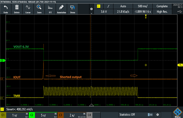

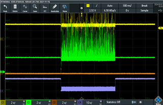

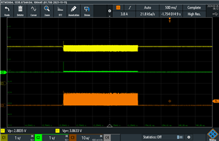

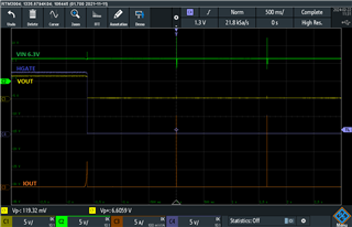

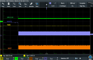

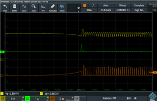

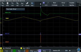

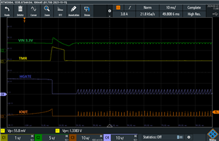

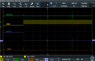

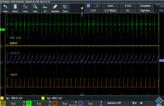

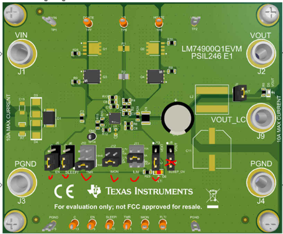

I use LM74900Q1EVM:

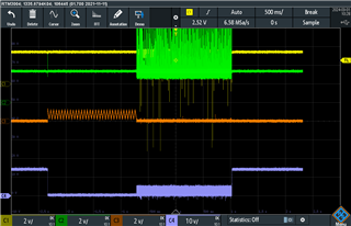

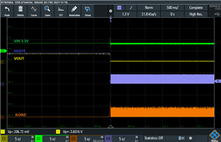

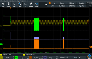

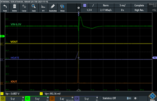

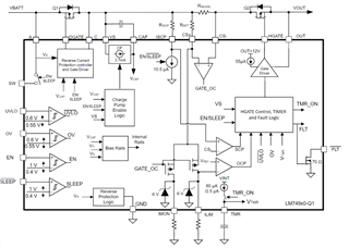

I reconfigure UVLO  to Vin min 3.3V -> short circuit protection didn't work correctly. : issue with circuit breaker timer.
