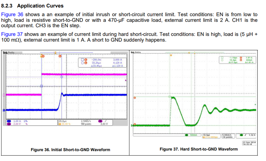

Question 1
Question regarding startup when TPS27S100 is ENABLEd
I believe that if you set a current limit value externally, it will clamp to that current value at startup.
In other words, if the current is limited to 2A externally, the rush current downstream immediately after ENABLE will be clamped to 2A. On the other hand, after the operation stabilizes after ENABLE, when the current reaches the current limit value, eFUSE turns OFF.

    Question 1
    Sorry for r my lack of explanation. This is a question regarding datasheet 8.2.3 section.
    Is the above understanding correct? If I am wrong, it would be helpful if you could point out which part of my understanding is wrong.

  • Hi Takemura-san,
    1. The understanding you described is not correct. The current limiting behavior depends on how strong the short is - Figure 36 shows a moderate short/overcurrent (you can see that the current increases to 2A over 8-10us), in which the device immediately limits the current, whereas Figure 37 shows a hard short to ground (the current increases to almost 2A, past the current limit, in under 2us), in which the device immediately turns off the FET, then turns the output on until the current limit is hit. The startup/steady state conditions that the figures detail are just for showing typical conditions during which these types of shorts happen, but a hard short can happen during device startup and the device would turn off the output then current limit, and a moderate short can happen after the device has stabilized and the device would immediately current limit.
    2. That is correct, when the device recovers after an overcurrent condition is removed or the device recovers from thermal shutdown, the subsequent output slew rate is limited to dV/dt(on).
    Yes, the current will always be clamped to ILIM or ILIM(TSD) even during recovery.
