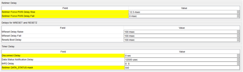

We are using the TPS65994AE on a Raptor Lake platform.  Using the GUI, I've set the GPIO Config register under Port 1 seeting to control power to the retimer and to reset the retimer.  What other key configuration settings are needed to work with a Burnside Bridge retimer?
  • Hi Jose,

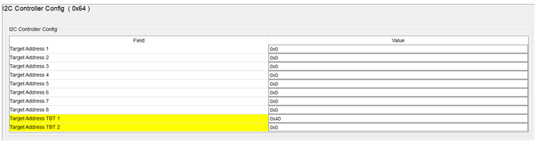

    You can check if the following settings are set correctly like below:
    0x43 Delay Config Register
    0x52 TBT Config Register
    0x64 I2C Controller Config Register
    Configure Target Address TBT 1 with the correct address.
    GPIO settings should be ok, just make sure they match the RPL reference design you are using.
    Let me know if you have additional questions.
    Alex
  • Thanks for replying.  I verified all of the settings from above.  These are all the default settings that come up when I start a new project with the TPS65994AE.  I've tried to use this image (with the updated GPIO settings using the GPIO Config register), and saved it as a binary image.  This was then programmed to the PD controller EEPROM using a COTS programmer.  However, this image does not seem to work on our board, ie. a Thunderbolt device is not recognized when plugged into the port.  I can share the schematic if that would be helpful.
