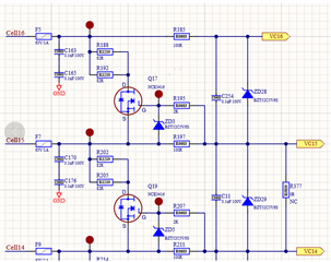

Dear Luis
1.We turn off the cell balance after 1s and still have about 12mV error
Below is our sch ,could u help to check the sch ?
Hello Gabriel,
The top resistor should be 20-Ohms for less error. Cell 16 is used to power the cell balancing circuit, again, this is described in Section 2.5 Voltage Measurement Accuracy During Balance of the Cell Balancing with the BQ769x2 application note.
Can they change the resistor to 20-Ohms and test again?
Additionally. I do notice that there are Zeners in the circuit. The Zeners seem to be too small, typically during cell balancing it is possible to see voltages of up-to twice the battery voltage between VC pins. So the Zeners ideally should be at least twice the expected battery voltage, to avoid them unintended turn-ons.
