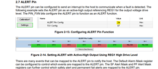

    If the above configuration is ok for host controlled -short circuit then an interrupt is not coming or you can say BQ not getting interrupt on ALERT pin.
    The output for short circuit we used currently is Capacitance bank and when we connect it then huge current up's and down but BQ not getting ALERT on that time. We monitor this on oscilloscope (no waveform is occurring) and the both MOSFET (chg and dschg) is ON on that time.
    Kindly share me the configuration for Host controlled short circuit with BQ
  • Hi Luis,
    Our Application requirement is to get an interrupt at ALERT pin when Short circuit detected. In all other fault we should not get any other interrupt.
    We are doing following settings steps by steps->
    1. We are configuring ALERT pin config by writing 0x2A. ,
    2. We are setting Short circuit Enable by writing in Enabled Protection A  0x80
    3. We are setting default mask alert (SSA) 0x4000.
    4. We are setting SF Mask Alert A 0x80.
    5. We are setting Short circuit detection threshold 7, (150 Amp). @ 1mohm shunt resistor
    6. We are setting Short circuit detection delay  15 us.
    7. We are setting Short circuit detection recovery time 20s.
    Testing Method->
    We are connecting a large capacitor bank 50k-75k uF.
    Observation->
    Our ALERT pin is low , after short circuit detection ALERT Pin consistently high.
    a.) How to reset ALERT Pin ?
    b.) please suggest what are we missing in our setting procedures.
  • Hello Arjun,
    Understood. So this sounds like everything is working correctly and you just want to know how to reset the ALERT pin, correct?
    In this case, the bits in the AlarmStatus (0x62) register are latched and the ALERT pin will stay asserted until these bits are cleared. You can clear the corresponding bit by writing a '1' to that bit in the AlarmStatus register. This is described in Section 6.6 ALERT Pin Operation of the Technical Reference Manual.
    Luis Hernandez Salomon
