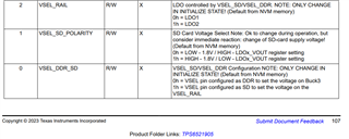

* VSEL_SD/VSEL_DDR: Active "H"

    VSEL_SD active high configuration looks good. MFP_1_CONFIG register bit [1] should be set to 1b so that HIGH signal on this pin causes LDO1 or LDO2 (depends on configurations settings) to be 1.8V output.
    Or, if you want LDO1 / 2 to follow the LDOx_VOUT setting, you should set MFP_1_CONFIG bit [1] to 0b according to your current pin strapping.

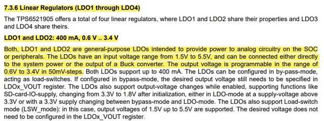

    The datasheet of TPS6521905 indicates that the output voltage of LDO1/2 can be programmed in 50mV steps within the range of 0.6V to 3.4V.
    Q1) Is it possible to program the output voltage of VLDO1 and VLDO2 by inputting VSYS (4.2V) to PVIN_LDO1 and PVIN_LDO2 applied to the circuit? Is it impossible?
    Please check. Thank you.
  • Hi Grady,
    Can you clarify the question? I'm not sure I understand.
    The programming of the LDO1/2 outputs is determined by the register settings. You will need to apply a high enough voltage to the PVINx inputs to account for the LDO dropout.
    There's not way to program the output voltage based on the PVINx input.
