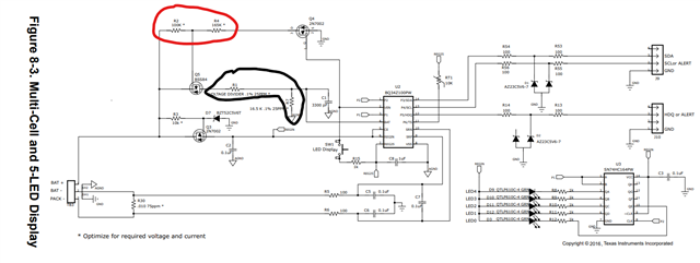

BQ34Z100-R2: Enquire for BQ34Z100-R2 Resistor Value
Part Number: BQ34Z100-R2
I would like to ask what resistor value can change for red circle as I am not sure what voltage point range and current flow is acceptable? What voltage should be for the red circle assume the BAT+ is 20 V, is it (165k/(165k+100k))*20V=12.45V. Same question for black circle also.
