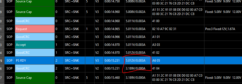

  • Thanks for the logs Ken, it seems like VBUS never rises to 12-V once the 12-V contract is negotiated. We are the sink correct? This seems to be an issue related to the source, from the messaging end, it looks like we do everything correctly. Once we send the request message, the source needs to accept, and should send a PSRDY once the 12-V is ready on VBUS. The PD logs never show the VBUS voltage rising to 12-V.
    Do you know if the adapter is compliant with the PD spec? Could you send a link to the adapter?
    Thanks and Regards,
    Chris

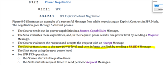

  • Hey Ken,
    I think that is an LED, not a Type-C Port.
    Going back to the issue an logs you provided, if we are acting as sink, our role in the PD communication is to request a PDO. The Source should be providing the correct voltage (12-V) once the PSRDY is sent, but this does not seem to be the case in the logs you sent which is why I beleive the source is non-compliant.
    Thanks and Regards,
    Chris
  • If the VBUS voltage is not at the expected voltage when the PSRDY is sent, we might fail upon connect.
