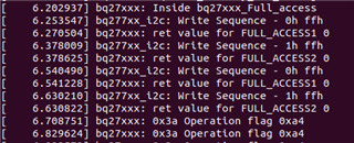

            I have attached a screenshot of the print statement added in my driver code. Showing the i2c write operation on the control reg.
    My unseal write sequence updated my operation flag 0x3a to 0xa4 in hex i.e setting bit sec[1:0] - 10  in Unseal mode.
    Bellow is my Full access write sequence: but my operation flag is still in the Unseal mode. sec[1:0] - 10
    I also tried adding delays between Unseal and full access write operations, but can not proceed from unseal to full access.
