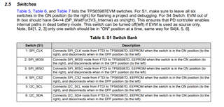

I am getting the "SPI Flash to Device failed verification" error pop-up after attempting to "Flash from current project" onto the TPS65987EVM.

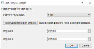

Here are my flash settings:
I get "Invalid region pointers read", unsure if that is related to my issue.

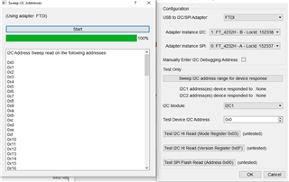

Here are my adapter settings:
When I sweep the I2C address range, I get 0x0 through 0x7E as the result, but afterwards I get this error pop-up:
I have tried completely reinstalling the GUI tool, attempted to flash with external power connected and external power disconnected, and attempted to flash different types projects, all with the same result. I have also tried this on the custom board which we implemented with a nearly identical hardware setup to the EVM with the same result.
