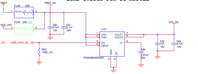

We are using this Load switch TPS22965NDSGR part in our design.
we are facing issue with this part for our 5G module , board is rebooting when we give voltage through load switch. The board is not rebooting when we bypass the load switch.
Our input Vbat is 3.57V, but we used CT value of 0.01uF as in datasheet?
Can you suggestion the correct CT value for 3.57 Vin.?
Thanks in advance for the reply.

  • Hi sathya Priya N,
    As mentioned here, this CT value results in a rather slow rise time as it is. Please try either increasing the CT capacitance to 0.22uF, increasing the input capacitance (please try 20uF and see how much the input dips), or using TPS22992 if possible as it has a lower minimum VBIAS voltage.

  • Hi Team,
    As per your suggestion we tried the following test cases:
    We changed Cin 22uF and CT 0.22uF it is still rebooting/crashing.
    we changed Cin= 22uf and CT=1000pF, it is stable but same time it is crashed/rebooted less frequently. (eg: in 20 times,3 times crashed)
    we need to confirm one thing, in the above circuit whether we need to change only CT ? or we also need to change Cin value?
    And, we want to know for Vin= 3.57V, how to calculate the CT value (if depends on rise time how we need to arrive for that? in datasheet we seen, it is given for 3.3V only.
    We are using the TPS22965N Load switch for 5G Power supply control (VBAT: 3.56V@4A Peak current)
    Two 5G modules we are using, in one 5G module we are facing this issue, whereas other 5G module is  working fine in the above circuit.
    Waiting for the response!
    Thanks in advance.
    Sathya Priya N.
  • Dear Patrick Shalton
    We tried CIN = 22uF and COUT = 10uF ,CT=0.01uF our observation 20 time 3 time device is fail. Currently improve but still some time failing.
    Kindly guide for Load switch CIN,COUT,CT value for support inrush current (5G Modem 3.56V@4A Peak current). we  not observed any voltage dip in supply line.

  • Hi Sathya, Vishal,
    Thanks for the updates. One thing I'd like to clarify is - when are you seeing your board reboot? When you are turning the device from OFF to ON? Or during normal operation? I don't quite understand, as I can't see a common scenario for the output be low after the soft start.
    My thought was that when the device starts up, perhaps the input voltage droops due to the startup slew rate or it overheats if the downstream components try to pull 4A during soft start, but it seems like at least the first part isn't the case. Are you using a constant current e-load, and is it on during the device's startup time?
    If the input voltage was drooping due to the startup slew rate, then adding more input capacitance would mitigate this issue. But since that's not the case, we should isolate the issue to know how to proceed. Can you attach a waveform of when you see this reboot happening so we can see what is causing it?
    Are you PWMing the ON pin of the TPS22965? And is there any difference between the two implementations of TPS22965 you referred to, especially in the load?
    At VIN = 3.57V, the rise time can be interpolated based on the data at 3.3V and 5V.

  • Dear Patrick,
    In our setup, we utilize a 3.5V@8A regulated supply for the SoM board, and a 3.5V@2.5A supply for both the Telit FN990 module and another component. The Telit module requires a peak current of 4A at 3.5V, which we manage with the TPS22965NDSGR load switch for software control.
    - Specifically, we observe kernel crashes during soft start, occurring approximately 2 times over 40 consecutive observations, while validating device ON/OFF conditions continues with CIN = 22uF, COUT = 10uF, and CT = 0.01uF.
    - Our load is connected to a 5G modem (FN990).
    We'll capture waveforms for further analysis and share them with you soon.

  • Hi Vishal,
    Thanks for the description, understood. It sounds like perhaps if the soft start is on the longer side, when the 5G modem turns on it starts drawing a substantial current which then drops the output voltage. Could you then try CT = open? Or, does the 5G modem require a certain slew rate when starting up?
