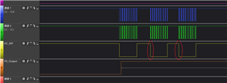

To test TPS25751's Source Role, we used some mobile phone such as iPhone, Huawei Honor, and so on. It seemed TPS25751 could NOT be compatible with some of them, some issue happened. Could you kindly help to analyze?
In addition, the related TPS25751 registers' data was read as following,
(1)When I2C INT was detected by MCU, delay around 500ms;
(2)Read 0x03, 0x14, 0x1A, 0x3F, 0x40, 0x34, 0x35 Register;
(3)Clear the I2C INT by writing all 1 to 0x18;
The related I2C data was attached as following:

1.iPhone15 Promax
It seemed the first try to establish PD contract was valid, but then a PD Hardreset occured. And it repeated this process, and could not establish stable charging process.
2.Huawei Honor
Same as the above iPhone.
3.Xiaomi Redmi K40
Same issue, but after this issue the charging process was stable.

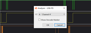

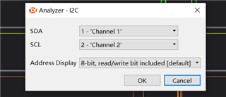

    I've been having some difficulty using the Kingst tool. Is there a way to export the PD log ot a csv or test file to make it easier to decode?
    Also, what are channels 3 and 5 connected to?
    Thanks and Regards,
    Chris
  • Hi Chris,
    The language of Kingst files is changed, you could retry to open these files. The logs in .csv format are also output and attached.
    The I2C's Kingst configuration is:
    The PD's Kingst configuration is:
    And you could see the decoded results:
    Data of my configuration:
    20240318_DataCapture.zip
    Data of your configuration:
    20240318_TIConfig_DataCapture.zip

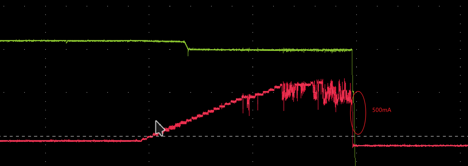

    Looking at the PD logs, could you obtain some additional information on the VBUS voltage and current at the time? We have seen similar behavior where the sink will draw too much power and the VBUS voltage droops due to overcurrent, resetting the PD contract and causing a constant restart behavior.
    Thanks and Regards,
    Chris
  • Hi Chris,
    OK, give me a day to book the lab resource and capture the data.

  • Hi Chris,
    We used another mobile phone Google Pixel 4, still the same issue. Its VBUS voltage and current are as following:
    And the related data with Kingst  logic analyzer is as following, notice the PD data seemed to change to display on Channel 5, which IS USBC1_CC1:

  • Hi Alex,
    The spike in current draw does seem to be causing the droop in VBUS voltage, how much current is being drawn, the scale seems to be in volts.
    Do you see this voltage droop on PP5V or VBUS?
    Thanks and Regards,
    Chris
  • Hi Chris,
    It is 500mA one unit, you can see the following for reference, the peak current is around 600mA:
    Do you mean the Green line in the pcitures? It seemed there's voltage droop on VBUS. Is it the cause for this issue? So how should we do to solve this issue?

  • Hi Alex,
    Yes, this is likely the cause of the issue, If the VBUS voltage drops too low, the PD negotiation will stop and reset. Can you measure the PP5V voltage on the same scope capture and see if the voltage follows the VBUS voltage?
    How much power is the DC-DC sourcing PP5V designed to handle?
    We first need to determine why the VBUS voltage is dropping before we can solve the issue. It could be related to the 5-V DC-DC, or could be an issue with the power path.

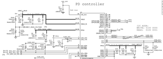

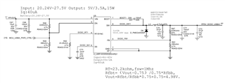

  • Hi Chris,
    OK, we will measure the related voltages and go back to you next week.
    BTW, could you kindly help to check our circuit desgin? Thanks.
    The PD is:
    The DC-DC sourcing PP5V is provided by:
    And the PPSYS is provided by the battery:
    Thanks and Regards,
    Alex

    BTW, we found the cause of this issue. The PD chip what we used was TPS25751D, I did not notice "TPS25751D has a integrated bidirectional high voltage load switch for sinking power path: PPHV", and I thought VBUS could only be supplied by PP5V, as the following picture indicated:
    Then for the charger BQ25751, it has the Reverse Mode, which could deliver power from the battery to the input(Here is PPHV for PD). So I enabled the Reverse Mode and found our system could charger the mobile phones such as Huawei Honor.

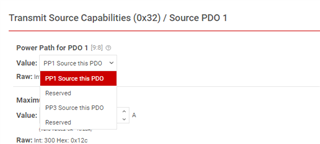

    (1) For TPS25751D configured as Source, how does TPS25751D know which source(PP_5V or PPHV) to choose? i.e, in which scenarios this chip would use PPHV? And  in which scenarios this chip would use PP_5V instead?
    You will specify which path in the json/firmware. If you select Advanced Config, then go to "Source_PDO_1" in the "Transmit Source Capabilities" Register, you can select the Power Path for PDO1 as PP1(PP5V) or PP3(PPHV)
    Get it. So
    (1)What's the advantages and disadvantages of PP5V and PPHV?
    (2) The default values of other PDOs such as Source PDO 2 in the tool are configured as PP3, could they use PP1? i.e, could PP5V supply higher voltages such as 9V, 15V, and even 20V?

    Suppose there's no delay such as the 500ms mentioned above, we captured the I2C data via Kingst:
    (1)1st falling edge on I2Ct_IRQ
    Interrupt Event for I2C1 Register(0x14h): 3_Plug Insert or Removal, 24_Power Status Updated, 26_Status Updated is set to 1;
    (2)2nd falling edge on I2Ct_IRQ
    Interrupt Event for I2C1 Register(0x14h): 21_USB Host No Longer Present, 26_Status Updated is set to 1;
    (3)3rd falling edge on I2Ct_IRQ
    Interrupt Event for I2C1 Register(0x14h): 12_New Contract as Consumer, 24_Power Status Update, 26_Status Updated is set to 1;
    That's why I think the chip needs some time to do its whole work when something happens. So which interrupt of  Interrupt Event for I2C1 Register(0x14h) should our MCU wait and then clear 0x18? 12_New Contract as Consumer and 13_New Contract as Provider seem not to be a good choise because they would not be triggered in some cases.
    Or our MCU should delay some time to wait for TPS25751?
    A 5-V source at PP5V is required for most Source applications, but by moving the 5-V power path from PP5V to PPHV, you can remove the higher current/power requirements for the DC-DC converter at PP5V.
    No PP5V is for 5-V source only, as mentioned above, a 5-V bus is required at PP5V for other reasons, not just sourcing 5-V.
