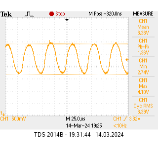

We have an unexpected behaviour in the series production of one of our PCBs. After some time, the output voltage of the two DC/DC converters starts to oscillate.

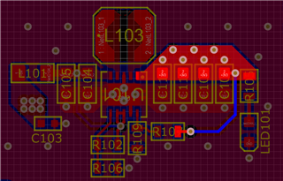

Layout U100 / TPS54160
Layout U101 / TPS63000

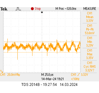

3V3 Stable:
3V3 Instable:
5V Stable:
5V Instable:

    In production they observed this behaviour, but measuring with a Mulitmeter the output Voltage is in spec. But leds are flashing and the communication with the Board was not possible.
    So I got some Boards for investigation and I've measured with an Oscilloscope.
    After a while (30min to 90min) the output behaviour changes.
    on the 3.3V converter ther is an LED which is blinking with 0.5Hz (1mA)

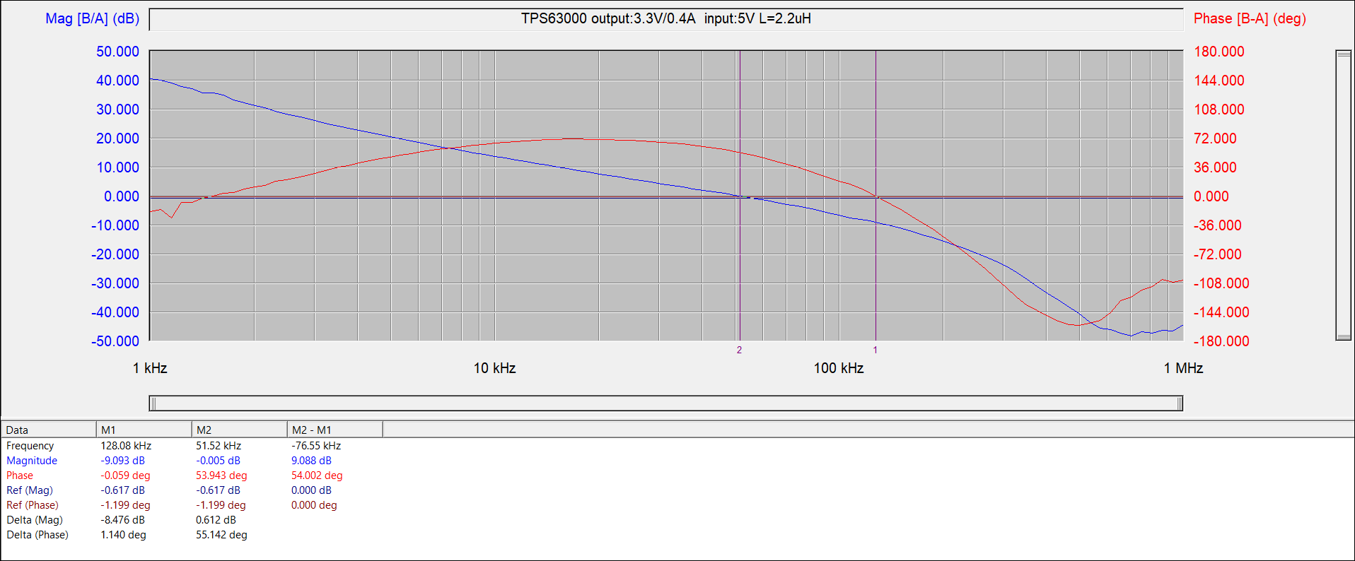

  • Hi  Fabio,
    Bode plot results attached below.
    2.2uH inductor--PM is 54deg and GM is 9.1dB
    10uH inductor--PM is 22deg  GM is 4.3dB
    Conclusion is with 10uH inductor, we will have stable issue and with 2.2uH, the performance is much better.
    Tao
