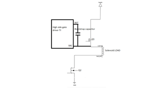

Hi Ti team,

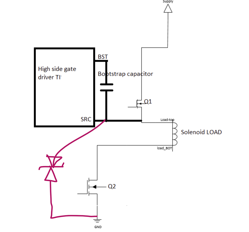

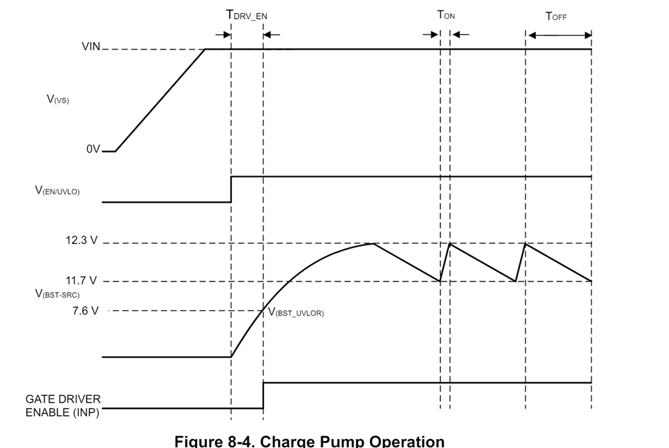

I want to consider TPS4811-Q1 in my circuit  selection.But i have some doubts for the fitment.
Q1 & Q2 MOSFETS i will operate at same time due to my application requirement. It is said that in TPS4811-Q1 datasheet internal gate driver charge pump of 12v will  charge the BST capacitor.
But if i operate Q1 & Q2  at the same time is any problem to charge the BST capacitor.
My doubt is
I will not  connect the BST capacitor. According to the internal gate driver architecture charge pump will supply the internal push -pull( PU,PD) TOTEMPOLE  MOSFETS.
Can i connect PU,PD pin directly to my High side MOSFET gate in above picture.
Does my High side MOSFET can b drived/operated -ON/OFF  without the BST capacitor .
can you please calrify my doubt or can you suggest me any solution to above doubt.
so that i can use this above gate driver for my application.
Thank you,
  • Hi Karthik,
    Thanks for reaching out!
    TPS4811-Q1 can be used to drive the high side MOSFET in your application. However, it needs bootstrap capacitor to avoid collapsing the bootstrap voltage during turn-on. you can connect PU/PD pin directly to the MOSFET gate.
    Please note the SRC pin can handle -30V only. So, clamping diode is needed at SRC pin as shown below
    Rakesh
  • Thanks for suggesting clamping diode due to the effect of load inductance spike on the SRC pin.
    But my  solenoid load inductance is 100mH.
    My application requirement is i have to Turn-On Q1,Q2 same time. So due to load inductance BST capacitor charging will be anything delayed ?? and the system operation is delayed is my doubt.
    I wan to know clearly two pints:
    1) If i turn-on both Q1,Q2 same time due to application requirement, how the BST capacitor will be charged and How  we can see the  voltage on PU,PD pin to drive high side MOSFET??
    2)There will no effect of Load or load inductance on the BST capacitor charging due to the gate driver internal architecture??
    Can you answer above two questions clearly please.
    Thanks in advance Rakesh!!
  • Hi Karthik,
    The gate driver internal architecture is designed to work properly irrespective of load type and its magnitude. The BST capacitor will get charged through a proprietary internal circuit to take care of this situation.
    Let me know if you have follow-up questions.
    Rakesh
  • Hi Rakesh,
    1) can you show that  with some sketch  in functional block diagram of datasheet for my better understanding for your answer in previous post .
    also my second question
    2) what is the minimum and maximum overcurrent,shortcircuit threshold detection limit i can do with TPS4811 smart gate driver.

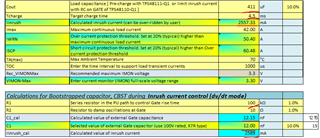

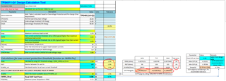

  • Hi Rakesh,
    In the design calculation tool it is recommended to set 20% tolerance for IWRN overcurrent protection threshold.Again 20% to the short circuit protection threshold.
    Is it really required for the design consideration or can i consider both OCP and SCP the same threshold
    for example my max worst case load current is 0.8A and i need OCP and SCP at 0.86A. so can i consider both OCP and SCP same value or any limitation is there ??

  • Hi Karthik,
    Rakesh-> The device has internal path from SRC to ground to provide path for BST charging when load is open. It comes in parallel with load.

  • Hi Karthik,
    For example, you design a system with Vsns=10mV and it has +/-20% accuracy. The design tool recommendation is to avoid any false OCP trip at max load current.
    Rakesh
  • Hello Rakesh,
    Yeah that is clear for me the margin between and OCP and max load current due to Vsns_wrn accuracy which i kept ( for my max load current of 0.7A i considered 0.85A OCP trip threshold which is +20% tolerance .
    But my question is can i keep OCP and SCP trip threshold same like 0.85A or in design tool it is recommending again to keep 20% tolerance to OCP threshold for SCP trip which i don't want in my application. i dont want margin between OCP and SCP trip.
    If i consider Vsns=20mv for both OCP and SCP threshold  in selection of Rsns,RIWRN,RISCP.
    So can i keep OCP and SCP same threshold  like 0.85A or do i have any design limitation in TPS48110 smart gate driver not to keep OCP and SCP .
    Thanks in advance rakesh
  • yes, you can keep OCP and SCP at same level

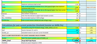

  • Hello Rakesh,
    Maximum load current in my application is 3.75A .
    I have considered VSNS_WRN =30.6 which has +/-3% accuracy.
    I have set 4A as OCP(Overcurrent protection) threshold and calculated Rsns and RIWRN
    VSNS_WRN 30mV
    OCP Current(Ioc) 4A
    RSNS 7.5mohm
    Power loss in Rsns 120mw
    RIWRN 39.66667Kohm
    Considering Vsns tolerance from datasheet and 1% tolerance of the calculated  RSNS resistor as shown in the below table.OCP thershold i got in the Range of (Min=3.83A,TYP=4A,MAX=4.15A)
    Min TYP MAX
    VSNS_WRN 0.02907V 0.0306V 0.03213V
    RSNS(ohms) 0.007574 0.00765 0.007727
    IOC threshold(A) 3.8383A    4A 4.1584A
    For my Maximum load current of 3.75A the OCP threshold range is (min3.83A,TYP=4A,MAX=4.15A) which doesn't have any overlap between Maximum load current and OCP range
    I have not considered design tool sheet recommendation of 20% tolerance to max load current and OCP threshold because i am not allowed to give that much tolerance to OCP threshold in my application.
    Is there any design limitation still there i can face problem with above mentioned values of  max  load current and OCP threshold??
    (Or)  it will be ok until unless there is no overlap between max load current and OCP threshold.
    Can you please check and confirm this Rakesh!!
    Thanks in advance Rakesh!!!
  • Looks fine Karthik. Please proceed.

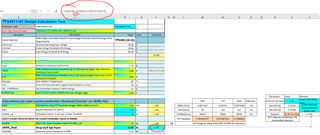

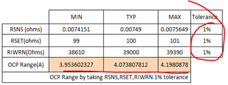

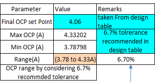

  • Hello Rakesh,
    First question:

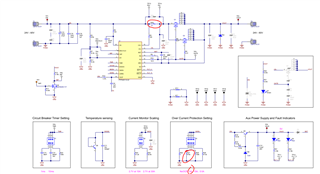

    ok ,but considering VSNS_WRN =30.6mV with +/-3% accuracy and Rsns resistor   1% tolerance is it sufficient to determine OCP threshold range (min3.83A,TYP=4A,MAX=4.15A,see above post for details) because there are two  formulas in the datasheet as mentioned below.
    I know second formula in the picture is to calculate RIWRN.So the tolerance of RIWRN and RSET resistor also effect the OCP threshold range know??
    After  calculating by RIWRN,  if  i consider second formula for calculation of  OCP threshold range, in that VSNS is not there in the formula.I know that Rsns is derived from Vsns-wrn.So considering that i can  take only only Vsns= 30.6mV but not the range of Vsns(29.2 to 31.5mv) which is +/-3% accuracy .
    second formula will consider only Rsns,RSET and RIWRN resistors tolerance but not the range of Vsns which is 29.2 to 31.5mv) which is +/-3% accuracy .
    So  can you please  help me how i can consider Vsns,Rsns,RSET and RIWRN all tolerance to calculate accurate OCP threshold range???
    Second question:

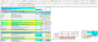

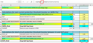

    I order to avoid the confusion of  manual calculation ,i tried to go with design tool excel recommended(TI).
    By considering 9% tolerance, i set 4.06A as OCP threshold point in order not have overlap with my application maximum load current which is 3.75A.
    Again in the design tool it is requested to consider 6.7% tolerance to the OCP threshold point which is show in picture below:
    Formula given for total tolerance=SQRT((6.6/100)^2+F25^2+F22^2) ---> what is that 6.6 fixed value considered. Because if i can reduce it in my application i can reduce OCP threshold range or it is compulsory to consider according to design recommendation ???
    considering 6.7% tolerance i got OCP range ( 3.78 to 4.33A) as shown below:
     But if consider only  RSNS,RSET,RIWRN  resistors 1% tolerance as show in picture below:
    I will get OCP threshold  range (3.95 to 4.19A) which is less than 6.7% recommended tolerance .So what is that 6.6 fixed value in that 6.7% tolerance??.If it is not compulsory to consider i will reduce to 2 to 3% or i will consider range as mentioned above.
    Attaching file also your reference
    TPS4811-Q1_26th.xlsm
    Why i am asking that much particular means Rakesh,OCP is very critical for us and the current  range is more means previous supply block in product will get failed
    Rakesh, Requesting you please check the above query and clarify it to me.

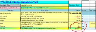

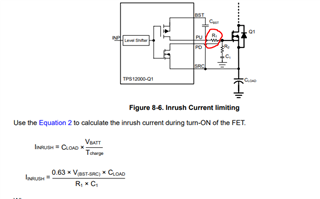

    Third Question:
    One more question in INRUSH current slew rate control :
    Why R1 resistor is recommended to be 100kohms??
    If i keep R1 =50kohms it will affect my chargepump (12V, 100uA) or bootstrap capacitor supply ??  any limitation with it??
    Thanks in advance Rakesh !!!
  • Hi Karthik,
    First question:
    Equation (1) is enough to calculate OCP accuracy. In the second formula, RSET and RIWRN comes in numerator and denominator which gets cancelled out.
    Second question:
    6.6 is total considering +/-3.3 accuracy. I might have taken it as +/-3.3% instead of +/-3% during initial excel tool development.
    Please take +/-3% + 1% for Rsns i.e., total +/-4% as accuracy for your calculations.
    Third Question:
    you can use 50k for R1 but accordingly C1 needs to be doubled to achieve same slew-rate control.
    BR,
    Rakesh
  • Hello Rakesh,
    Thank you but in second question answer you  said 6.6 which is  +/-3.3 accuracy. but doubt is why i have to sum-up 3.3+3.3=6.6% accuracy or  3+3=6% accuracy.
    Already i have final OCP set point of 4.06A shown below in picture. i have to take  +3%  accuracy to 4.06A which gives Maximum OCP=4.18A and
    -3%  accuracy to 4.06A to get minimum value which is Min OCP=3.938A
    (Min OCP  =3.93A,MAX OCP=4.18A) which does'nt overlap with my maximum operating load current of 3.75A
    That could be fine right..summing up of 3+3 =6 % tolerance is  not necessary i think so.
    If above my answer is fine means, i will take total  +4%  accuracy(1% for Rsns )  to final OCP set point which get MAX OCP threshold
    and same -4%  accuracy to final OCP set point which get Min OCP threshold.
    Let me know your comment on it, if it is ok i will proceed Rakesh
    Karthik
  • summing of accuracy is not required. Please proceed.

    In the datasheet  tolerance is given only for  V(SNS_WRN) 30.6mV and 10mV.
    But i will be using  VSNS_WRN =33.42mV due to current sensor resistor available for us.
     could you please check and tell me what is the tolerance for VSNS_WRN =33.42mV
  • Hi Karthik,
    The accuracy at 33.42mV is in the same range as 30.6mV. you don't get much improvement.

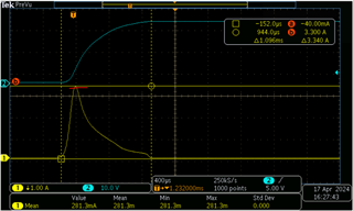

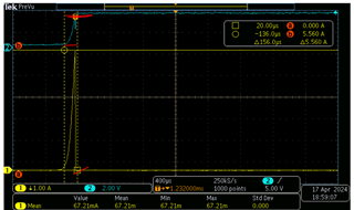

    some more questions on inrush current.
    question 1:
    i am doing tps48110 EVM testing and  I set OCP threshold =3.5A .
    Now we kept capacitive load of 105uf  to check inrush current control of our application requirement and by using the design tool we calculated
    INRUSH current =2.67A which is less than my OCP threshold of 3.5A.
    According to the recommendation i kept R1=100kohms and C1=3.3nF for gate of the MOSFET .According to the calculation it should turn-on for 1.1ms with inrush current of 2.6A approxmately.
    But you can see below waveform,we are facing an issue .
    INRUSH current it is taking of  5.6A and OCP fault is triggered and you can see output is not even raising to 28V for 1.1ms. Just at 4V it is taking 5.6A and going to fault mode
    Kindly Can you check and let me know the issue??
    question 2:
    Now we checked for 40uF capacitor load ,we did'nt changed the R1=100kohms and C1=3.3nF for gate of the MOSFET and set Tcharge time of 1.1ms only
    but according to design tool calculation the inrush curent should be =1A.But we are observing 3.34A current  as seen in below waveform.
    Acutually my application requirement is, we have 120uF capacitive load and we need inrush current of less that 3.5A by providing MOSFET gate turn-on slew rate control of 500us.
    We are working on high priority to freeze the design requirements ,Kindly please check and give the suggestions at the earliest.
    Thanks in advance!!
  • Hi Karthik,
    The inrush current profile depends on the FET parameters and their non-linearities. The external cap on the gate gives you flexibility to limit the inrush control but there is no closed loop control as such. If peak current is causing a concern we need to increase C1 to meet the requirement.
    Let me know if you have any more questions.
    BR,
    Rakesh

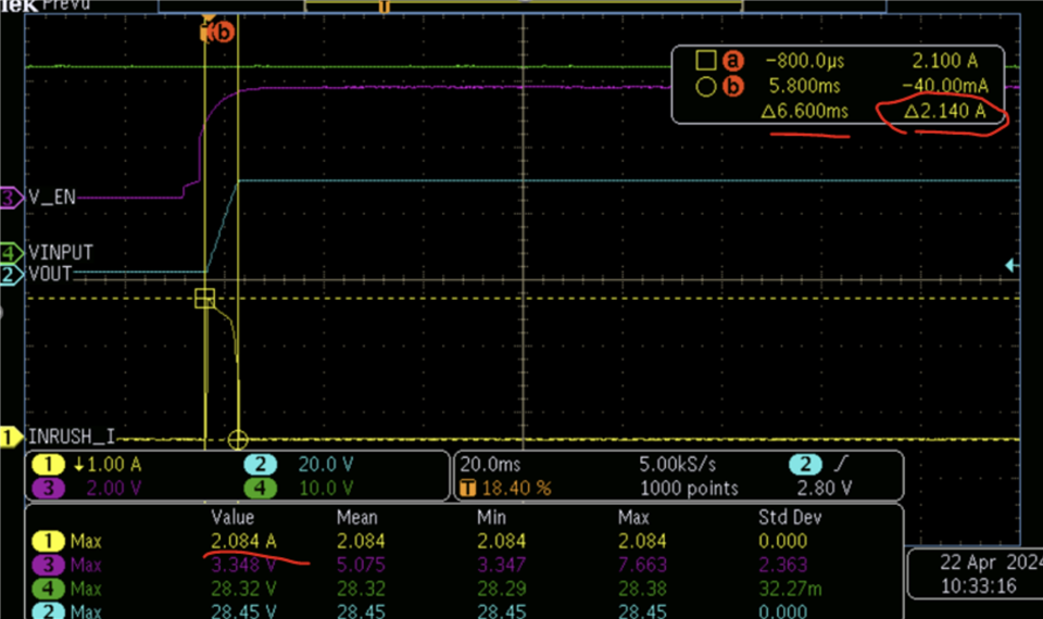

  • Hello Rakesh,
    I am testing TPS48100EVM ..
    I kept CLoad =411uF and for  Tcharge time of 4.5ms the required  R1=100kohms,R2=10ohms and C1=12nF  kept for MOSFET gate.
    But during testing i am not required turn-on time according to the calculation ,i measured the  R1,C1 values with DMM  and i kept on the board to observe the typical turn-on time ..but not meeting the aproxmate time.\
    I am getting 6.6ms for turn-on time  instead of 4.5ms as shown below
    In the EVM Ti is using AUS300N08S5N012ATMA1 MOSFET which has Qg =231nC and for 12V Vbst voltage obtained  C=Q/V, Cg= 19nF and
    Ctotal =C1+Cg=31nF.
    If i consider  R1=100kohms,R2=10ohms and Ctotal=31nF then the turn-on time =12ms that is also not matching.
    You have any idea  Rakesh why the deviation is coming ??
    or something i am missing??
  • Hi Karthik,
    The inrush current is a function of V(BST-SRC). When you enable EN=HIGH, the V(BST-SRC) is building up the voltage so the inrush current is lower than the calculated value with V(BST-SRC)=12V in the tool. So, the turn-on time also increases.
    Can you make EN=HIGH first and then use INP to enable the output. Then we should see closer result to the design tool values.
  • Hi Rakesh,
    i know that actaully and  i am doing also same way in the EVM board.I am doing EN=HIGH first and  then INP making high .
    Based on that only i am getting above post results  as mentioned getting I am getting 6.6ms for turn-on time  instead of 4.5ms as shown in above post .
    Still not understanding what is the isuue??
    As i mentioned it is due to Mosfet gate capcitance?? but still it is different if i take that into account..
    Let me know ifyou know any opinion or suggestion on it.
  • ok. you mean CH3 in the below waveform is EN or INP ?
    Can you please capture BST voltage instead of VINPUT and share with me.
    I don't think Mosfet gate capacitance is playing major role here.
  • Hello Rakesh,
    Yes the lable name is not correct ,i kept  V_EN label name but i captured INP only .
    Ok will try to capture the BST  voltage and then we can discuss based on the observation.

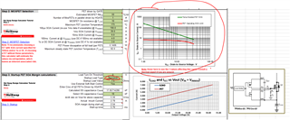

  • Hello Rakesh,
    I used INRSUH_FET_SOA  Ti excel tool for SOA.
    Actually i need SOA derating for Tam=85 degree what is the allowed current.
    In the temperature derated SOA  curve (Green line) current is higher than normal curve (red line)? .generally it should be less than that know..
    Also i will using for inrsuh current with active slew rate control .So is there option for start load type capacitive ?? in the tool it is showing only constant current or resistive.
    I will sharing you to your email id the design calculation with all the iputs feeded for the selected MOSFET.So please check and give your suggestion on it.
    Thanks in advance rakesh!!

  •  Hello Rakesh,
    First question:
    Could you please check and tell me what is the tolerance for VSNS_WRN =60mV,125mv which is not mentioned in the datasheet??
    Second question:
    In the EVM board testing , if you observe in EVM schematic RSNS=500uohms and OCP is 5A then VSNS_WRN=2.5mV and in testing it is exactly tripping and good.
    It is mentioned in the datasheet we should not use less that 10mv  due to noise issue.But it is tripping exactly .
    But after that i changed the RSNS=8.3mohms in the the EVM board which has VSNS=WRN=31mV and OCP trip should  in between (3.8 to 4.3A) according to my calculation in my design.But the trip is happening at 3.6A which is my operating load current
    so at VSNS_WRN=2.5mv or less value  OCP trip accuracy is good??  or at VSNS high value like 50mV or 100mV OCP trip  accuracy is good??
  • The accuracy at 31mV should be better than at 10mV. In your case, may be solder resistance is adding up and tripping at lower current than expected.
    Beyond 30mv, the accuracy remains same.
