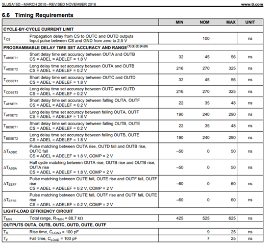

    The following table from the data sheet shows the accuracy of the delays over temperature.

    I received information about the accuracy of this IC against temperature changes.
    Thank you very much.
    Is it safe to assume that this information also includes the variation standards for the IC itself?
    Also, how should we think about aging deterioration?

    These device parameters are documented in the data sheet.  I am not sure what you mean by variations standards can you clarify?
