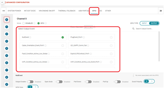

Hey guys,
I started playing around with the TPS25762Q1EVM-146 devkit and managed to successfully flash the board with a brand new configuration, but ever since then charging does not work. Is the original JSON or XML configuration file available somewhere for this board so I can use that as a basis for my configuration? In the release files package there is only 45W and 65W dual port configs. I don't really know what I'm doing wrong.
Thank you in advance!
Greetings,
Peter
  • Hello Peter,
    1. Which GUI version and Base FW version are you using to program the EEPROM?
    2. Which TVSP setting are you using? In other words, which J7 header pins are you shorting with a jumper to configure the boot mode?
    3. Attached below is a 65W JSON that I created for you.

    I would like to program one of the LEDs to indicate charge state. So when the phone has been fully charged, the LED would turn off. I have been using the SRC_PWR_Greaten_Than_Threshold_Event_Port1 event, but the LED stays on even after charging has been stopped. Is there any event that I could use to indicate the charge state? I was thinking about reading out the charge current value through I2C with the help of an MCU, but I would avoid this if there is another way.
    Could you send me a list of all the available events, please?

  • Hi Peter,
    Glad you to hear that the issue was fixed.
    All GPIO events are listed in the GUI in the Advanced Configuration View's "GPIO" tab (see image below), but there isn't one to indicate full charge.
    If you would like to use I2C to read VBUS current and other telemetry data, please see this related E2E post.
