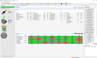

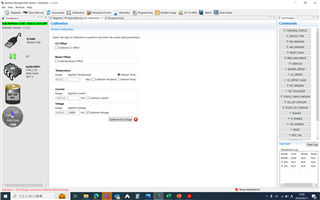

BQstudio does not recognize the battery correctly.

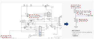

When I checked the voltage value of BAT PIN, it was 0V.

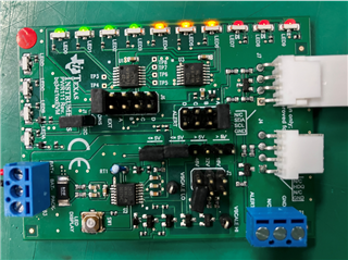

 The pin configuration on the top of the EVM is as follows.
The battery is 24 V. Referring to the guide, the jumper pin is connected in the following configuration.
J2 at 32 V
J3=A
However, it is correctly recognized when operating at 4 V with a pin configuration for less than 5 V.
J2=open
J3=A
Please tell me about the pin configuration of jumper pins when operating at 24 V.
