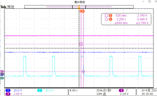

When I used bq76952 to control the FET, I used low-side FET. When undervoltage protection occurred, the CHG FET seemed to turn off abnormally. When undervoltage protection occurred, the device actively turned off the DSG FET. Then the host uses commands to close the CHG FET, but the CHG FET is closed and then opened in the middle.
The oscilloscope shows light blue is DCHG , pink is DDSG, the process is undervoltage, and then CUV Delay 0x01, CHG FET is closed by the host using the command.
Here is my configuration.
DCHG 0xA2;
DDSG 0xA2;
CFETOFF 0x02;
DFETOFF 0x02;
FET_CHG_PUMP_CONTROL 0x00;
Want to know what causes this and how to solve the problem?
Look forward to your answer, thank you
  • Hello Zhang,
    Command should not be used to control the FETs when the DDSG/DCHG pins are being used. That may be why you saw this.
    See the following thread:
    https://e2e.ti.com/support/power-management-group/power-management/f/power-management-forum/963339/bq76952-need-clarification-on-ddsg-and-dchg-operation

    This is the latest oscilloscope waveform I obtained. After appearing in CUV, DDSG and DCHG are controlled by commands, and then CHG FET is constantly opened and closed. Is this also caused by using commands to control low side FET?
    Thank you!
  • Hello Zhang,
    With that threshold, that makes more sense. With a 1-mOhm sense resistor you can handle up-to 200-A of current accurately. Do you expect currents higher than this?
    You could even use a 0.5-mOhm sense resistor to handle up-to 400-A of current. That'd be more accurate than using a 0.125-mOhm sense resistor.
    That is possible. We do not recommend to use the FET commands when controlling low-side FETs with the DDSG/DCHG pins. This is detailed in the Technical Reference Manual. This older E2E also explain in detail why DDSG/DCHG should not be used with FET commands:
    If you want to control the low-side FETs with your MCU, you should use the CFETOFF and DFETOFF pins instead.
