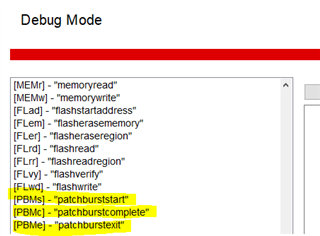

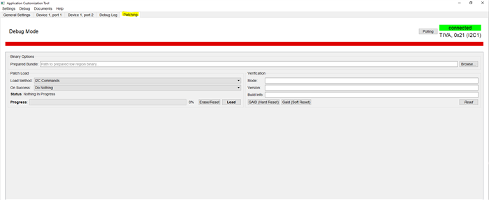

  • Hi Alex,
    From my understanding of the conversation so far, you are attempting to perform patching using the GUI in debug mode to the EVM. Can I confirm that you are using the below method to patch?
    Or are you using the individual 4CC commands over I2C?
    The officially supported way to do patching with TPS65994AD and TPS65994AE is through the PBMs, PBMc, and PBMe commands. The details of these commands are specified in the Host Interface Technical Reference Manual, available on the TI mysecure website.
    The PTCx commands you see the GUI using are older commands that were used with previous generation devices (as used in SLVA972A). Newer devices such as TPS65994AD and AE use the updated PBMx commands for patching. However, the older commands were not removed, as this was not necessary.
    The GUI cannot support the PBMx commands because of the USB to I2C bridge "TIVA" mcu we use on the EVM. This "TIVA" IC emulates an EC embedded controller in your system, that sends commands to the TPS65994 over I2C. This TIVA I2C bridge we use does not have sufficient SRAM memory space to support PBMx, patch burst mode. In burst mode, the entire PD firmware must be loaded to the EC embedded controller before it streams it to the TPS65994 block by block in custom sized bursts. PTCx does not require this. Because of this, the PBMx commands require a lot of SRAM memory to complete. This is why the GUI does not use PBMx to patch the PD controller. The PTCx commands also patch the PD but require less SRAM memory in the EC. Our TIVA USB to I2C bridge does have sufficient memory to support PTCx. We do expect that most customer ECs will have the required memory space to support the PBMx commands.
    Please see more details about the PBMx patching commands on our technical reference manual and let us know if you have additional questions.

  • Can I confirm that you are using the below method to patch?
    Yes, I was using that "Patch Load" feature shown in your first image when testing out how the GUI tool sends a patch bundle.
    Understood. Thank you, this answers both of my original questions.
