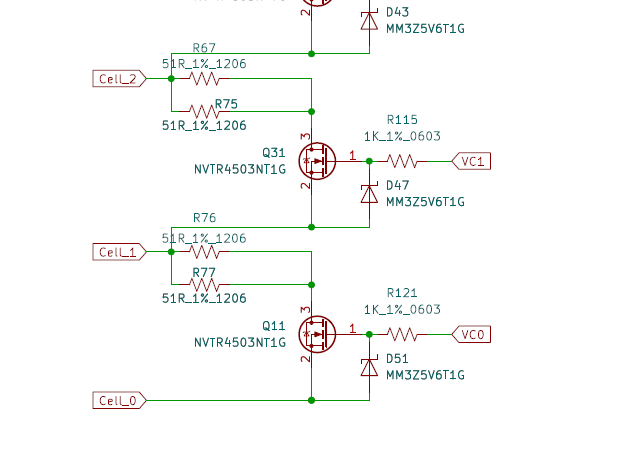

Hello TI Experts,
I am trying to control Cell Balancing using Host Commands, I only set 0x0083 CB_ACTIVE_CELLS() to control cell balance and do not provide any voltage threshold.
After setting the 0x0083 CB_ACTIVE_CELLS() I can also confirm that I read back 0x0083 CB_ACTIVE_CELLS() and both the set and read data match. I am using 25.5 Ohms resistor for balancing.
For some reason I do not see the balancing being active (the reason I say this is that there is no voltage drop across the resistor and also  the gate is not turning ON). Also when balaning is ON the temperature on balance resistor is expected to rise which i see constant and not rising at all.
I have pasted below config resistor values can you please check below and help me understand why the cell balancing is not turning ON?

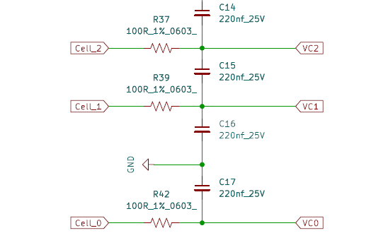

Cell Balancing Circuit:
Vcell to BQ76952 Connection:

  • Hello Vikram,
    You mentioned that reading from 0x0083 CB_ACTIVE_CELLS() is showing the correct cells are being balanced, correct?
    You should try using an oscilloscope on the pins that are being balanced (According to 0x0083 CB_ACTIVE_CELLS( ) ), so you can confirm that balancing is actually active.
    If you do see that balancing is active, then there may be a problem with your schematic or layout.
