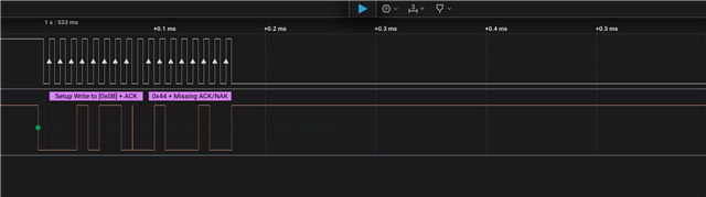

  • This is a custom design.  It's a custom MCU.  I am attempting to write a 32 byte block of flash memory.  The exact packet that I am attempting to write is as follows:
    0x44, 0x22, 0xC0, 0x48, 0x87, 0x51, 0x5E, 0x10, 0x25, 0x10, 0xFD, 0x0F, 0xF4, 0x0F, 0xEC, 0x0F, 0xE8, 0x0F,
    0xE2, 0x0F, 0xCA, 0x0F, 0xBB, 0x0F, 0x8C, 0x0F, 0x75, 0x0F, 0x58, 0x0F, 0x42, 0x0F, 0x30, 0x0F, 0x10, 0x0F, 0xE5

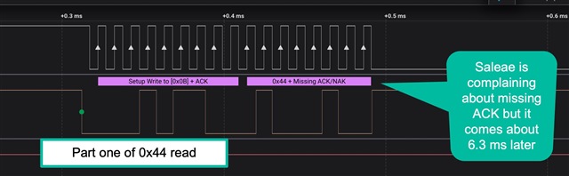

    The point is that I get a nack on the first byte after the 0x44. I don't even get to the address part of the
    packet because I get a nack. So What are some things that would cause the BQ40Z80 to always nack? Its responding
    (aacking) the SMBUS address and the 0x44. It's rejecting me for any manufacturing access.

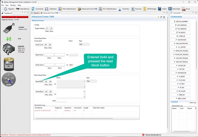

    The device has never been sealed. I can connect it to BQStudio and read some registers. But as soon as BQStudio
    attempts to do a manufacturing access read. It gets nacked forever. So it looks to me like its locking me out
    from any manufacturing access.

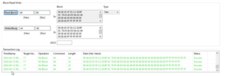

    Below is an example of a successful read. Using BQStudio and an EV2400

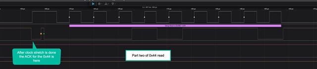

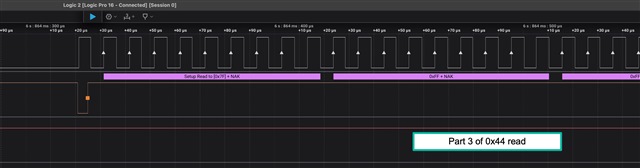

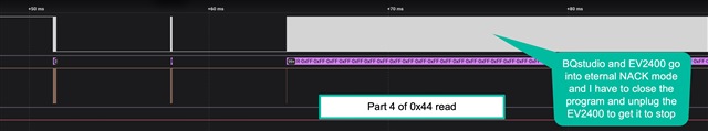

    But below is a failed manufacturing access read using BQStudio. I have broken it into three pictures so you can see
    details after the clock stretch is over and so you can see that it just nacks forever. BQStudio never gives up
    and I have to close BQStudio then unplug the EV2400 to stop if from infinitely waiting for the 0xFF nacks to end.
    It does not matter if it's my custom MCU or BQStudio with an EV2400. All manufacturing access fails.

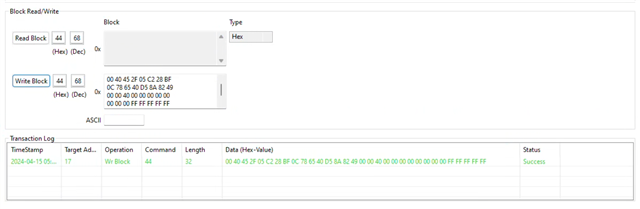

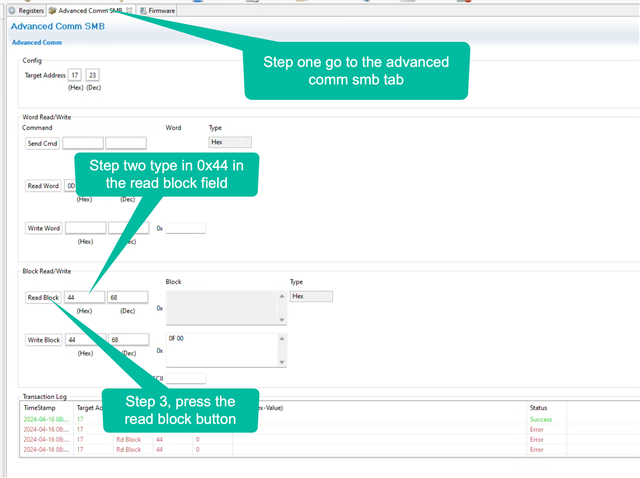

  • Hi Chet,
    Thank you for the details, I believe that if we can debug this on bqStudio, then it will make debugging the MCU issue clearer.
    Regarding how this is being communicated in bqStudio, can you please tell me the process that you are using for the write? Below is an example I did writing to 0x4000.
    Command 44 is being used, along with addressing the register in the beginning of the data as 00 40, then the rest of the data that is looking to be written.
    Please ensure that while doing this, the Auto-Refresh in bqStudio is turned off.
    Can you also please tell me what register you are attempting to write to in the example above?
    Anthony Baldino
  • OK no problem using bqStudio to trouble shoot.  Please see below a successful write with a chip that is in a good state.

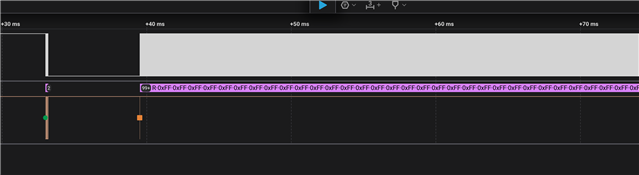

    Here are my results on a chip that is in a bad state for a read transaction
    So back to my original question when we started this thread "Any suggestions on what would cause the chip to refuse any access to flash?"  What would cause a bq40z80 to just refuse any manufacturing access read or writes?
  • Hi Chet,
    I see that on the unit that is in a bad state, there is a "Timeout or unexpected response communicating with the device" error. Below is another E2E thread where someone using bq40z80 was able to mitigate the same error.
    https://e2e.ti.com/support/power-management-group/power-management/f/power-management-forum/836311/bq40z80evm-020-timeout-or-unexpected-response-communicating-with-device
    If this solution does not help, please let me know and we can look further into it.
    Anthony Baldino

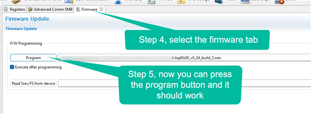

  • I am able to use bqstudio and reprogram the firmware in the bricked boards now.  It's a bit quirky on how I have to do it.  If I attempt to just program it always gets rejected with a CRC error.  If I attempt to do a read block at 0x44 it gets into an eternal loop of NACK but then when it is in this eternal loop of NACK I can then hit the program button and it will figure things out and program the firmware.  I found this solution by trial and error.
    Any thoughts on what's up with this being the magic combination to get this thing to reprogram?
    Do you have documentation on how to program the BQ40Z80 independent of bqstudio and the EV2400?  Its not realistic to use bqstudio and an EV2400 in mass production.

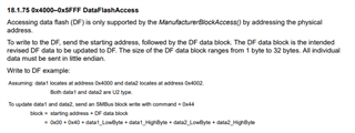

  • I am still trying to figure out why the flash get randomly corrupted and its necessary for me to refresh the firmware to recover the chip.  I am doing calibration on the device.  When I do calibration I write to the calibration data flash area that starts at address 0x4000.  is there any problem with writing to that area one register at a time?  For example I do a write of 2 bytes of payload to the cell gain register that starts at 0x4000.  How about if I write two registers at a time for the case of current calibration?  I do a write of 8 bytes of payload starting at address 0x4006 and I write the ccgain and capacity gain in the same write.  Does that raise any red flags?
  • Hi Chet,
    The device should not have any issue writing to a single register, or multiple registers as long as it fits the formatting seen below:
    The only issue I could see if the registers you are trying to write to are not in order, such as 0x4000 to 0x4002, and so on.
